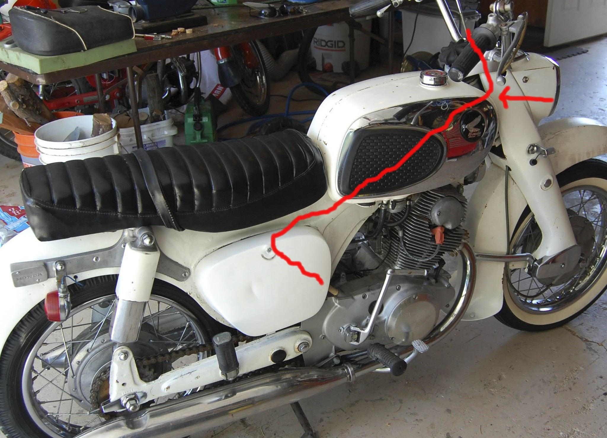

Ok I will try a photo.
The red arrow is pointing to the lube fitting
cable was the same length as the old one
cable from left side of headlight at the hole on the side to the right side of bike into hole on frame down tube into air cleaner out side cover to clutch. Now notice that my cable is more to the back of the cover.

Post by LOUD MOUSE » Wed Sep 19, 2007 5:55 pm
I suppose ya did fill the threads on the adjuster and inside the part it fits into with high temp grease. How many friction disc in the clutch.
I'm also concerned that when the kick lever is folded in that it isn't indexed to 11:00. ...............lm

Well that is an old photo and yes I have changed that kick start lever it is very close to 11:00 now. As to the clutch well umm you built it for me LOL. This is that pain in the ### in Denver. As too a hint the Dove was not that good for shooting this year.

I thought that was the one I sold ya. Is there plenty of grease in the adjuster threads? The cable does go in nice smooth turns?. ........lm

Well I put grease in the cable nipple but not at the ends I will do that this weekend and look at the turn in the air cleaner it would be the sharpest turn in the setup. Something is binding to be sure today's ride I had a popping of the cable as I squeezed it a not smooth but dragging feel. Starting to wonder about how good the new cable is.
