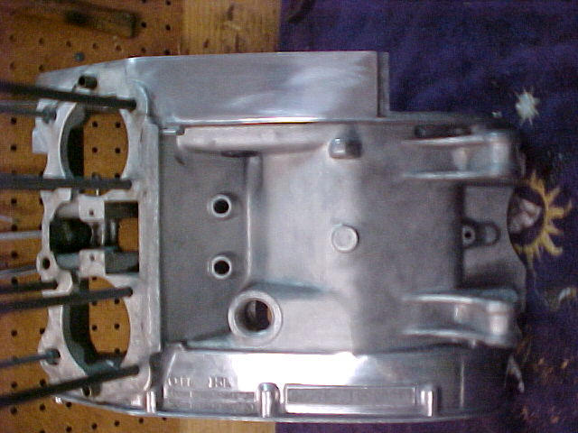

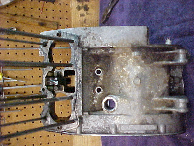

Today I did the upper engine case. Removed evrything possible, thoroughly cleaned, bead blasted, polished outsides of case, and cleaned three more times, finally brake parts cleaner and compressed air through all oil passages, bolt holes ets. Here's before and after pics of cases. Next will be transmission. Gears will be Xed, and pics will be posted. I hope everyone finds this interesting.

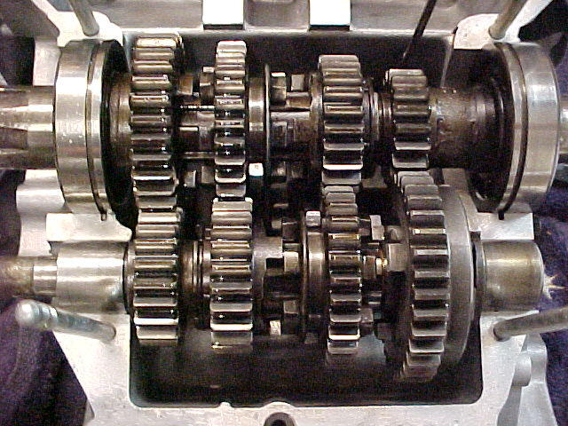

So, trans gears have been Xed and installed . They will have to be removed to slide new seals, and kickstart pawl and spring when they arrive. Xing the gears tightens up the ratio between first and second, and second and third gears. Much nicer for riding around town, or running through the twisties. This is accomplished by removing the gears that slide, and the gears that are held on with clips, on both trans shafts, and switching them over to the opposite shafts. Here's a pic of the trans installed in upper sase, and parts page showing which gears are done. I always install trans and crank in to upper case when reassembling.

Nice looking case Dave, I been getting somewhere on my rebuild also. Today I got The weisco 60.50mm pistons bored to fit the ebay dream clys. they look real nice. My trany is also Xed, I read it in an old magazine years ago and tried it. The jump from first to second is much less, which is cool, cause you know how it can be the Big One. The difference from second to third,is close to stock, so that's OK. The only draw back comes between third and fourth, where it is now a big jump. Like you say, at lower speeds, it can't be beat! Also the closer ratio between first and second makes that shift easier to get right. Keep up the good work, post ya later
