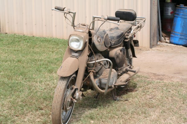

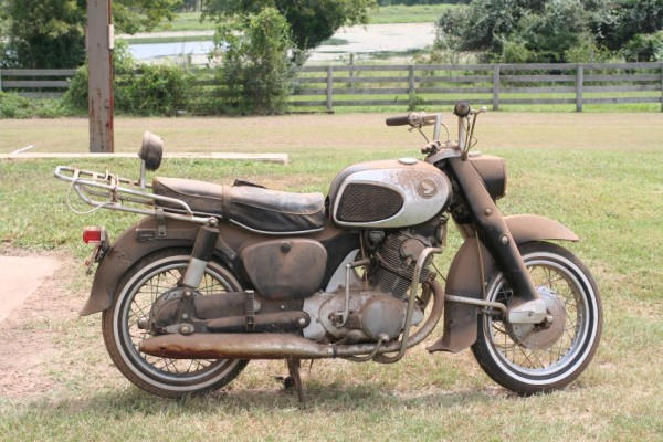

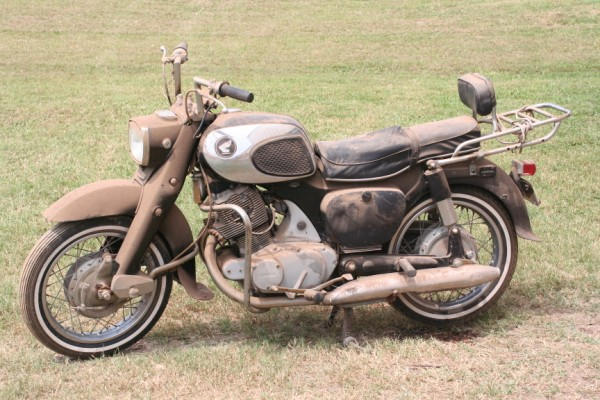

This is believed to to a 1966 305 Dream although we have not located the paperwork to verify the year yet. It's my dad's bike that was given to him 25-30 years ago and has been sitting in his barn for probably the last 15. We drug it out on Sept 2 to see what it would take to get it running and then decide how far to go with it from there. Since that time I have bought a battery, put in a new carb kit, petcock kit, cleaned and lined the rusty tank with POR-15, set the timing, valve and points clearances, replaced the starter solenoid and thats pretty much it to get it running. I also bought the Bill Silver cd, which so far seems to be a great resource. The clutch plates were not releasing so I dissassembled them, cleaned them up and they seem to be ok for now. One of the most frustrating problems was the shifter. It would not stay on its shaft and kept slipping off the spline, dangling useless until the bike could be limped back to the garage in whatever gear it happened to be in. The thought of tearing down the transmission to replace the worn shaft didnt sound attractive so I tapped a hole in the center of the shaft and used a screw/washer to keep the shifter snug. Its actually working very well. So, the engine does run and the bike is rideable but it runs way to rich, fouling the plugs in 10-15 minutes. I think it may be a piston ring problem since I only have about 125psi on both sides. I added oil to the cylinders and the compression shot up to over 200 on the 1st test and then droped by 10-20psi each test after that until it got back down to 125. Seems to indicate good valves & bad rings? My next step therefore may be dropping the engine and reworking the top end.
Trailered for the ride home after a quick wash

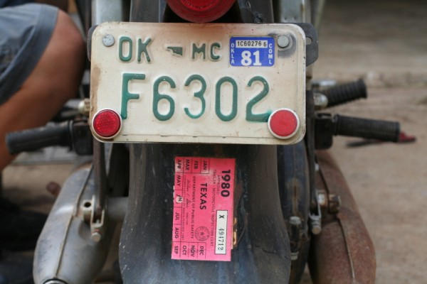

Last time it was street legal was 1981
Fresh from the barn3
Fresh from the barn2
Fresh from the barn
Fresh from the barn

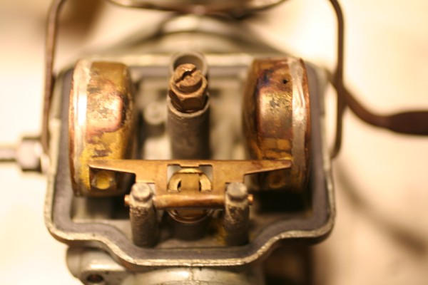

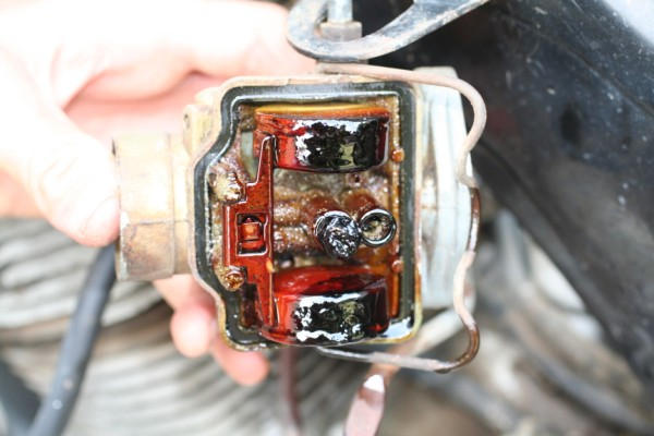

The carb was badly varnished but cleaned up after several days of soaking and a new kit

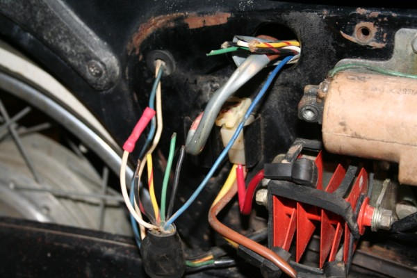

Wiring damage repaired

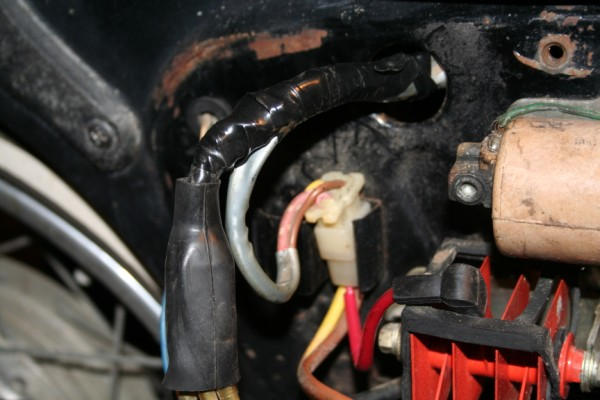

Mice nesting in the frame had chewed through several of the wires.

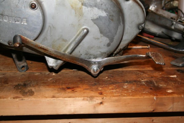

Attached is a picture of what I did with the shifter. It was easier than finding a new shaft and replacing it, and if it still ever has to be replaced there's no harm done. The shaft would be thrown away anyway.
Foot Peg Modification

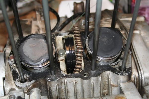

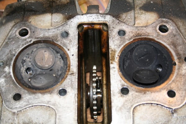

I tore down the top end yesterday and the cylinders, pistons and rings all look fine. I dont think they are the problem. Now the attention shifts to the valves, which are pretty crusted over and seem to be sticking. I will be taking them to a local motorcycle shop to be cleaned up and re-ground if necessary.

Cant find anybody here willing to work on a bike this old so I started taking the valves out myself tonight. It wasnt as difficult as I thought it would be with a good C clamp. I am only doing one side at a time to make sure I get them back in their original cylinders. But, now its appearing like LM was right and this is a waste of time. I havent found anything wrong other than some carbon buildup that may have worked itself out eventually if it werent running so rich. So, I pulled the carb apart again and this time found a small pinhole in one side of the float. That's probably been the problem all along.
...after a little bit of poking with a screwdriver to see how bad it was.

Pistons
Pistons
