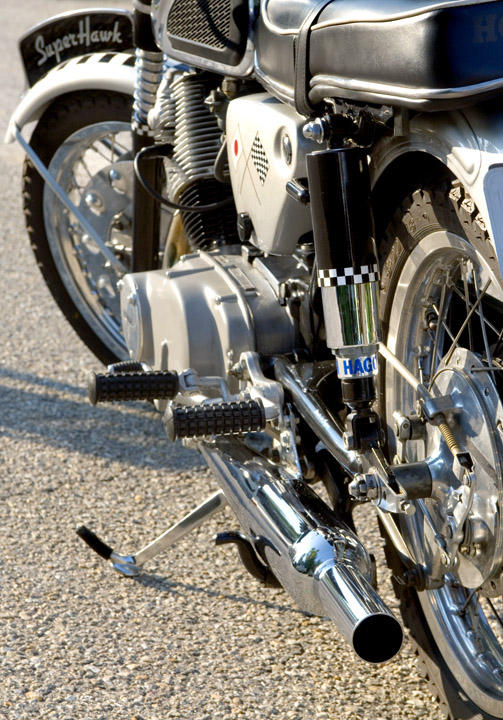

Apex has a new style on eBay now:
http://cgi.ebay.com/ebaymotors/_W0QQitemZ250180321111
I think I like these better than their other style.
But $250??? That is crazy for what is essentially a chrome plated, slash cut tube with one bracket welded on!
Here is a business opportunity for someone if these sell at $250, because I bet someone on this forum can build 'em and sell 'em for much less!

Could it be the tip has a large hole in it?. ...............................lm
Many years back I bought a CL77 for parts. It came with stock pipes and some baffles in each. When I was able to remove those baffles I found them clogged/coated/layered with carbon soot. The baffles were fro the C/CA/CB72/77 bikes and with the holes on the outside only the exhaust wasn't able to get out. The correct CL72/77 baffles have a smaller center and 2 locating areas to keep them in the pipe and not rattle. Take a good look at the inside diameter of the pipe then look at the baffle and you tell me this won't give 95% back pressure. .......................lm

Heck if you're going to spend that much money, you could get two sets of EMGO mufflers from JC Whitney. They are definitely better quality than the Apex mufflers, look right, sound right, and definitely flow better. The only thing to watch out for is the mounting channel on the backside of the muffler....they could fracture over time, but I'm sure it would be an easy fix if they did.
Or, if you wanted to be super cool, get a pair from Armours or Norman Hyde in the UK!
