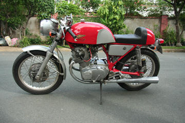

i recently fixed up an old 66 superhawk. My mechanic put delo gold sae50, if i ride the bike for more then 45 minutes the clutch dosent seem to engage it becomes really hard to shift, its hard to find neutral. When the bike is in motion it is easier to shift gears but when i stop its harder to put in neutral . What could be the cause and remedy for this, your help would greatly be app, by appreciated thanks, i routed my cable in the straightest possible manner its going over my tank so no curves whatsoever

First I recommend ya replace the oil with a good (NAPA) 30W non detergent oil.
Second that trans probably like most of the others will have the"find neutral while stopped" syndrome.
Most of us go to neutral before we stop. ............................lm

All 9 of my Honda's exhibit the same problem. If you come to a stop while hot without finding neutral first, you can pretty much forget it. It won't go into neutral til' ya shut the engine off.
A well tensioned drive chain seems to help this issue quite a bit on most of my bikes, though.
