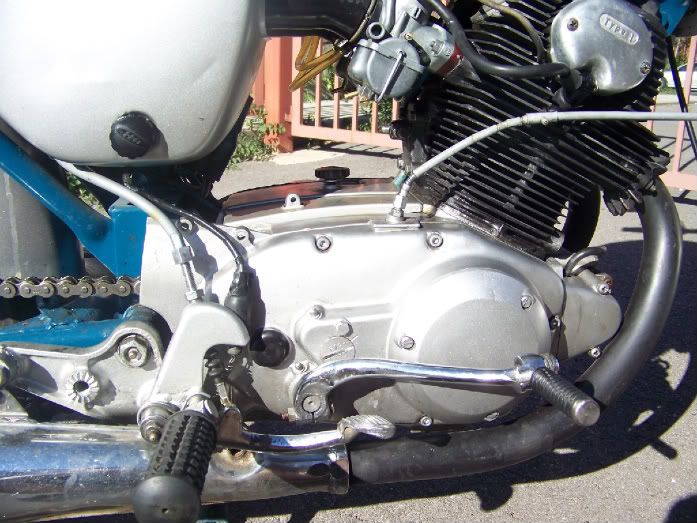

Gun
Posts: 632
Post by Gun » Sun Sep 07, 2008 6:33 pm
Having an issue with my kick start. It doesn't spring back after a kick on it's own. When driving makes a rapid light ticking noise in the case unless i manually bring it all the way back and keep it there.

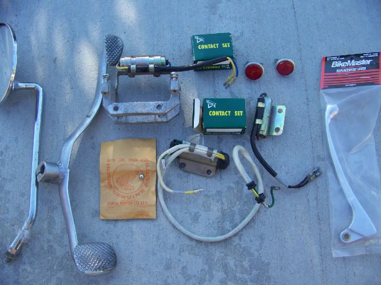

also I acquired a box of cb77 goods from a guy. Free of cost, but not sure i understand/recognize much of it. at least, I don't know what the stuff with the wires are. that top left one has a metal frame attached to it :/ any info on those?
