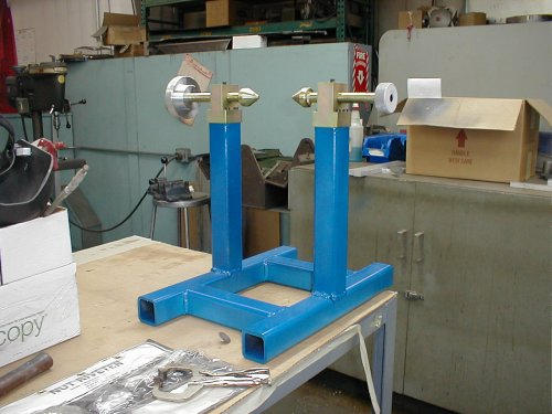

Not yet Ron, Getting the bodywork painted in a week or so. Got the tank sealed last weekend. Built a truing stand for the rims (See attached photo).

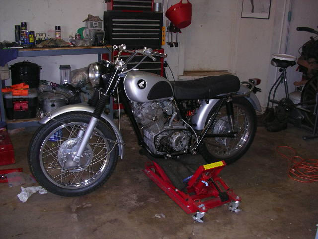

I'm getting there
Nice stand, hope it works well for you...... Here's a pic of where I am, things are going quicker thanks to LM. I am not doing the chrome yet as it isn't in the budget. All I really have left to get is a chainguard, but so is everyone else.
