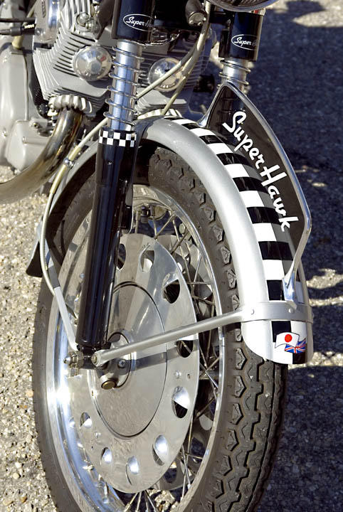

Have you looked at Dunlop K82's (also called TT100 Lightweights)? I switched to them from Cheng Shin a couple of years ago, and I just love them. They look appropriate and they stick like glue -- very confidence inspiring. Of course, they are more expensive than Cheng Shins, but I think they're worth it.
The big problem in the U.S is that 3.00x18 and 3.25x18 aren't popular tire sizes, so you're limited if you're srictly looking at U.S vendors (someone please correct me if I'm wrong here!). I've also seen praise for IRC tires elsewhere on this Forum.
Wheel House Tyres in Birmingham (UK) has the K82's, and I usually get them in a week via Fed Ex. www.motorcycletyres.com, or 011 (44) 1675 464221 (if calling from the U.S).
The photo shows the tread of the K82.

I haven't tried anything other than the Cheng Shin's and these Dunlops. One of the things that sold me on them was a tire test that Classic Bike Magazine did a few years ago, and the Dunlops were rated by them as the best all round tire, particularly for their cost, performance and looks (their least favorite were a pair of Mitas (formerly Barum, I think), which I think would be in line with the Cheng Shin's). As I say, in the United States you'll be limited by the available tire sizes offered by U.S distributors, so a look overseas may offer some wider possibilities.
