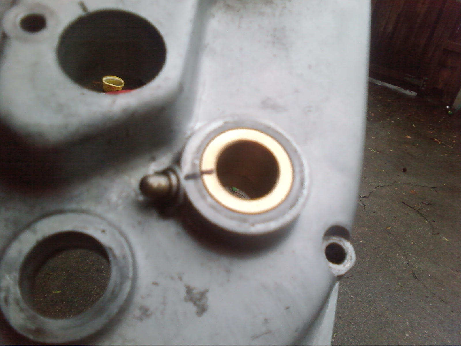

Kickstarter Bushing
Here are some shots or the Kickstarter Bushing my uncle made.  Can you think of any reason this material--oilite--may be wrong for this application?
Re: Kickstarter Bushing
Looks good to me. ..........................lm
						C.N. wrote:Here are some shots or the Kickstarter Bushing my uncle made. Can you think of any reason this material--oilite--may be wrong for this application?
