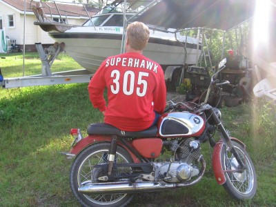

Hello all! Just picked this girl up Monday night from Perdido Pass, FL. Great condition for sitting under a beach house for 15 years! Owner had built a "lift" to keep it off the ground during hurricanes.
Any help would be appreciated in identifying some of the anomalies I've noticed such as the little "bullet" turn signals on the headlight bucket, the chrome side pans, after-market(?) exhaust, 2-tone paint & seat.
I'm a ratty guy by nature so I'm only going to do a mild resto focusing on the motor & wheels while probably leaving the rest as-is. In rust we trust! ;)
Fresh off the truck:
A little navel jelly/wire brushing & elbow grease:
Just ordered a carb rebuild kit, solo seat, & rectifier. Found a local that has a couple he shows regulalry so hopefully this baby will be up & running in time for spring! Thanks for looking!

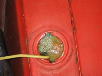

invizibletouch wrote:Oh, I'll begin tackling that tank tonight. Fun times yes? LOL!
This is how I remove rust from tanks.
Supplies: 10amp battery charger, Bolt (zinc or steel), 3ft. 10 gauge wire, water, Sodium Carbonate (Pool/Spa chemical PH+).
Mix 1/4 cup sodium carbonate for every 2 gallons water. Fill tank all the way full. Strip both ends of 10 gauge wire and twist one end on bolt. Attach other end of wire to pos. lead of batt. charger. Place bolt in tank suspended by wire. Clamp Ground lead to good ground on fuel tank. Plug in charger. It will bubble and start to have a crud foam form. Every couple of hours, remove bolt and rinse crud away, also pour more solution in tank to wash top crud out. Do this until no more crud foam appears (one to two days). Drain and rinse tank. Blow dry and put handful of 1/4 nuts in tank and shake (will Knock black oxide off). Blow out with comperssed air and you are good to go.
This process only eats rust not steel. It converts rust to black oxide. The surface left behind is rust resistent, and does not need coating (unless there is a leak). Acids will leave a surface that will rust quickly. Try it, it worked great for me.
