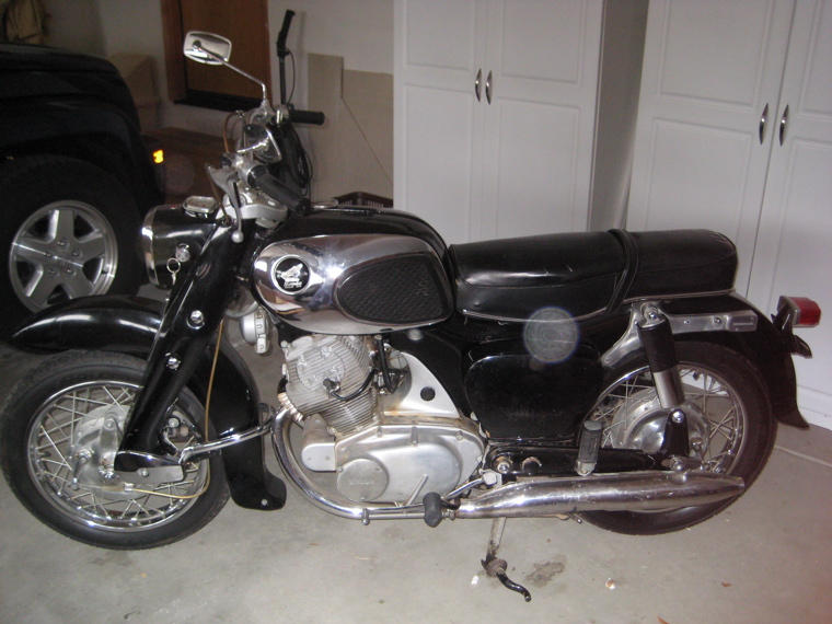

I have just purchased what the title says is a 64 CA77 which I believe to be true. The VIN on the title is CA78313566 and the engine number is CA77E-318818. I cannot find the VIN on the frame anywhere and need it to get a VIN verification from my local police due to the out of state title. Any suggestions? I have posted a picture.

On the lower left bottom near the LS rider peg on the side below the tool cover. ..................lm

Sorry to be so dense but I am not finding it. On the left side of the bike is the battery compartment, and just below the foot peg is the exhaust pipe. On the right side is a covered compartment with all the electrical connections and below the foot peg again is an exhaust pipe. Am I missing something?

On the left side between the battery cover and driver foot peg bolt.
It's stamped into the frame at an angle. ..................lm

Finally found it.... Boy, is it buried! I can just see my local policeman standing on his head to read the numbers......
