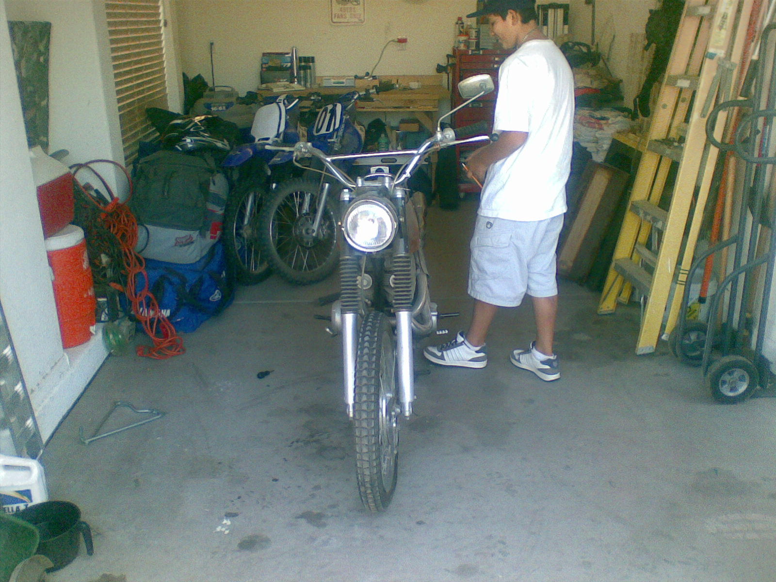

I have an 68 CL77 that I have been lugging around for over 15 years. It was my old bike back in high school. Now my son is coming of age and about ready to take it on. I want to do a complete build ground up and have completely stripped the bike down to frame.
As eager as we both are to rip into the next steps, 1) Paint, 2) Parts, 3) unknown. The question is where to start?
Do i rebuild the engine first? Paint/polish/finish so when it runs its finished? Never doing this before, I am inclined to paint and polish first to when it is done, its done and not being riding around 1/2 done.
My son is aching to crank into the motor, but I resisting... any thoughts on where to start and what manuals/books/tips/tricks are available?
