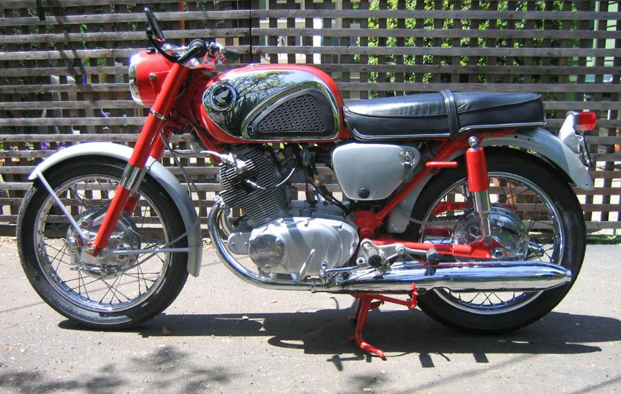

Loud Mouse,
I don't dought your reply. The P.O. did work for Goldengate Honda in Mayfield Hts Ohio (Cleveland). I found this picture showing hoses. I did go on to other classic bikes. 1970 H1 Kawasak, 1976 RE5A, RD250, KH400, Silverwing, Silverwing Interstate, CB350F with NOS pipes. Had to hang up the helmet this year. Wrenchs are still being used. Dick <><
