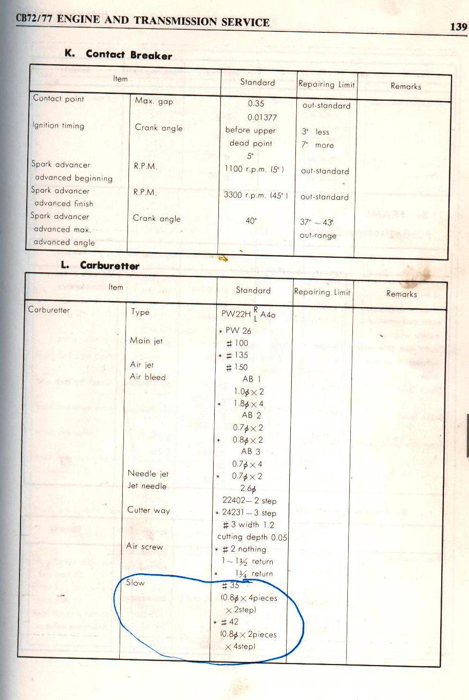

Also, in my Clymer book (attached pic), the slow jet indicates a #35 and a #42. Is it supposed to be different. What does the asteric signify?
Post by LOUD MOUSE » Sun Apr 06, 2008 5:49 am
The (*) is next to all 305 size engine parts. .............lm
kylechanh wrote:I'm kind of new to carb repair. You guys talk about the "slide screw." Is this the throttle stop screw? The one that looks like a thumb screw?

I'm guessing that the previous owner did not know what the (*) signified and replaced the slow jets. I thought it was weird. I guess I'll be looking for a carb kit. I'll post my progress. Thanks to all for your help. I'm sure that I will have other questions.
