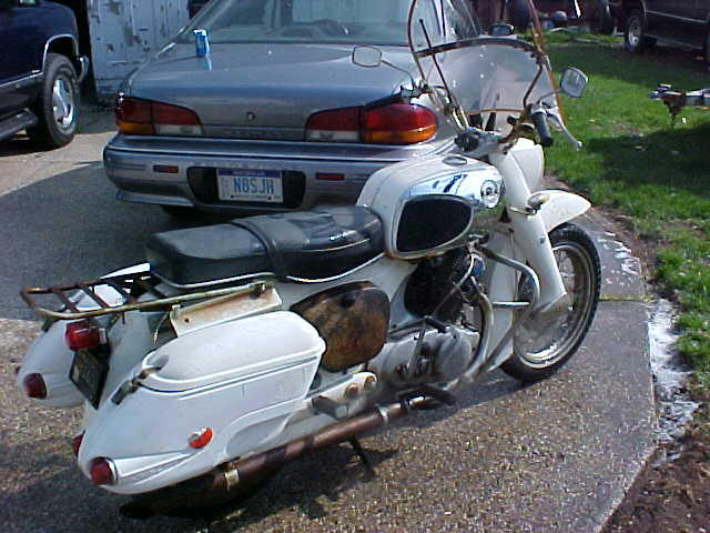

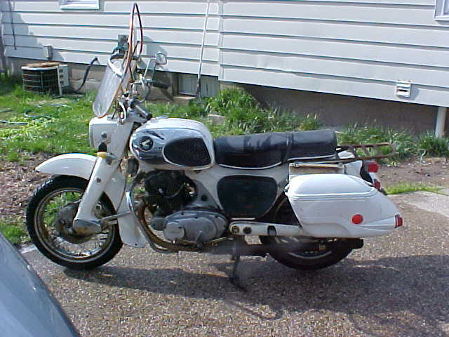

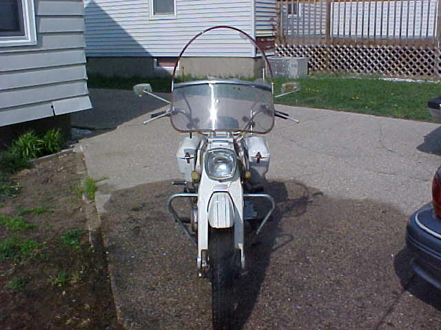

Please bear with me as I have never had a motorcycle before. I am 30 yrs old and have always been more of a car guy until this passed by me. This Honda Dream was my grandfathers. I am not sure what the year is for sure. All I know is that it was his first bike that he bought and used until he something happened to it and he just parked it and later bought a Harley. Well both grandparents had passed quit a few years ago and this has sat at my dads. He wanted to clean things out of his garage and asked if I wanted it so I picked it up for free. All he knows is that something is wrong inside the clutch or transmission. He does not think the motor is froze but not for sure. So going into this thing blind. All the parts seem to be there nothing has been robbed from it just needs to be fixed and cleaned hopefully.
I need to know what kind of manually is the best bang for the buck in all aspects of teardown and assembly as well as maintaining this bike? Im sure I will be on here to ask questions but would like a manual to help get things rolling and get familiar with the bike. Thanks
Here are a few pictures after I gave it a quick bath to take all the dust off. [/img]

Congrats on the Dream.May be worth your while to read alot of the old posts on here to get info, I know I have.Ebay is a good source for Owners manuals or service manuals.How many miles on it?Bike appears to be at least a 65', but if you give the VIN number someone else may be able to pin it down further.May want to start with a new battery(12N9-3A) to check the electricals on it before attempting to start it.Clutch pack is probably seized from sitting for years also.Carb. probably needs cleaned and new plugs and timing checked and points checked out and adjusted and fresh oil for starters.Good luck.

grats on your new bike! my best advice is read read read. i read through every post on this forum several times over a period of 2 years before i got started on mine (in the midst of it now). You seem to have a very nice bike to start with, should have little difficulty polishing it into a gem! i'm green with front fender envy, mine is crinkled like alot of other.
parts manual and bill silver's guide are key.

Looks like youv'e got the right idea, try to get as much dirt a grease off, without scratches. congradulations on your good fortune. Their's not a thing this form can't help you answer.
