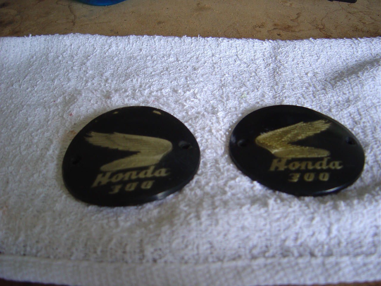

Has anybody ever tried to reshape a set of original Honda plastic badges ? There is quite of bit of glazing and one is cupped badly. Will low heat make them mailable or do I just have a nice set of desk ornaments.

I ask this same question a few years ago of a gentleman restoring a CB77 that had some pretty but badly cupped and scratched badges. He said he uses a heat gun and gently, repeat gently, heats the plastic while it is laying flat to eliminate some if not all the cupping. He also mentioned acetone will remove the scratches and bring back surface shine. I have not personally tried this, but you could end up with a twisted mess if you move to fast on this since most heat guns get really hot quick. Maybe someone else has tried this method before.

The technique is described on the VJMC page in the tech tips. You have to be a member to get to that page. $30 membership versus ruining $300 worth of badges; it seems like an easy decision.
