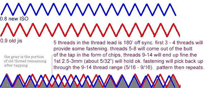

i've heard of alot of people retapping the 5mmX.9jis with the new 5mmX.8. i can't advise it. in short threading scenarios it probably works fine, just nudging a thread or two into place. on longer thread it would inevitably nudge the material right out of place.

Thanks Davomoto and 3BeanCrispy. Both useful info. At this point it seem the easy option is to just retap it to the 5mm 8 pitch. Since it's just holding that stator cover on and a short tap... no pressures or leaks to worry about...

for retapping these make SURE and retract the tap often and <if u have> compressed air to blow the chips off of the tap and out of the hole. make sure to oil the tap to help it cut rather than tear. i drew up a quick sketch of what happens when you retap .9 to .8 showing the alignment of the threads and what it 'hopefully' will leave for intact thread form.
additionaly, metric drill size is the nominal thread size minus the pitch. a 5-0.9 would use a 4.1 mm drill, where the 5-0.8 would use a 4.2mm drill. not a bad idea to check the hole size before you put the tap to it. granted it should be only .004 inches difference, everything is manufactured with tolerances, and assuming what it is based off of what it should be will burn ya when ya least expect it.
