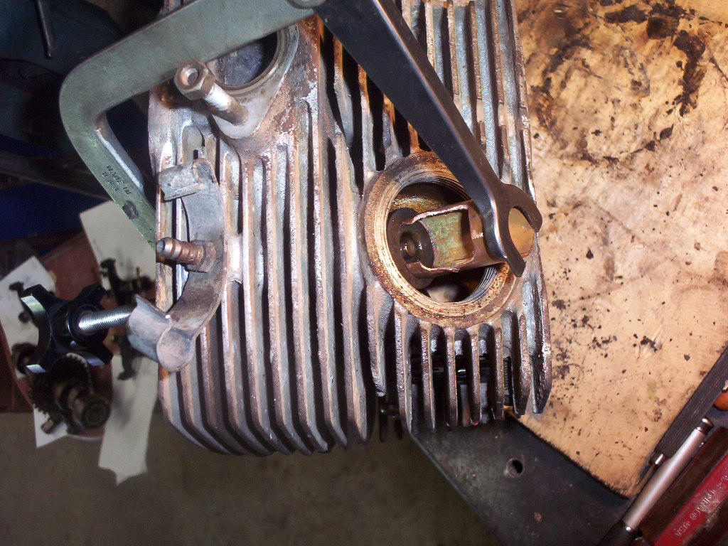

Hahnda's method is what I used, but the small engine clamp I had did not leave enough room so I cut a piece of 3/4 copper pipe as and extension and notched part of it out to access the keepers.I posted a picture.Joe
