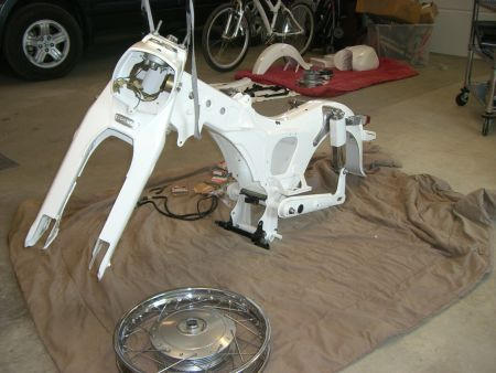

By the way,
Here she is so far.....
And about the difference of the rear and front rims......Anyone?
