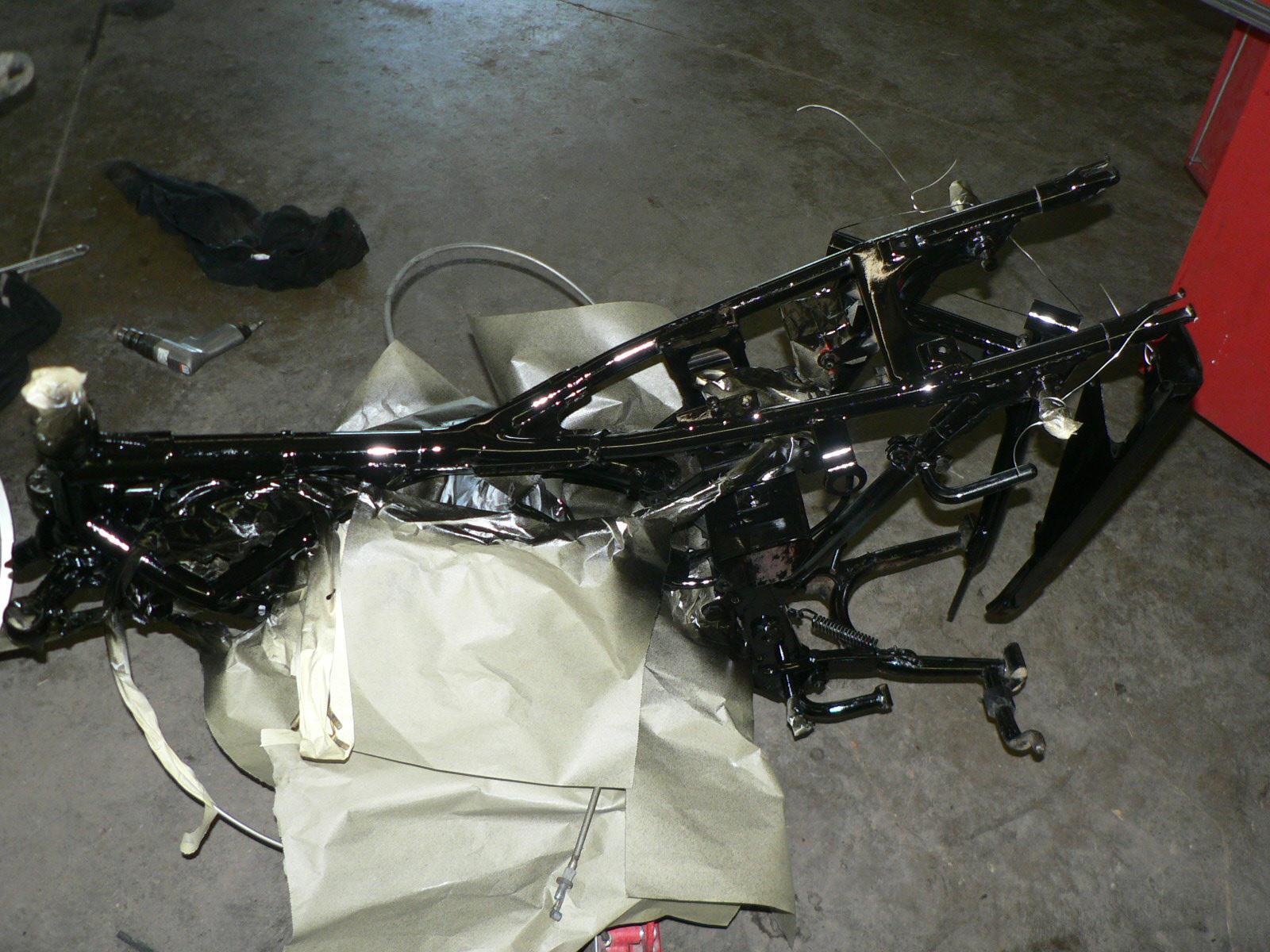

Post by AWILLIAMS64 » Mon Sep 01, 2008 9:19 pm
i know its not a total rebuild, but here is my start...frame painted, and i am currently stripping the fenders, side panels, and gas tank to get it back to the bare metal.

I'm not sure the original question has been answered. I have a 64 CB72 in blue, the paint looks original, but the frame is black - is this a correct spec?
Pic here:
http://www.toastyhamster.plus.com/IMG_2057.JPG
Ignoring the front guard is this all standard? The blue 72 in the "nearly finished" thread has inspired me, but the frame is blue and the guards are silver so maybe my 72 has been painted at some stage.
Post by LOUD MOUSE » Wed Sep 03, 2008 11:27 am
The bike was issued as Black. I see silver under the blue on the filter cover and black under the blue on several parts. A good clue that is has been over painted is the blue rear fender. .............lm
