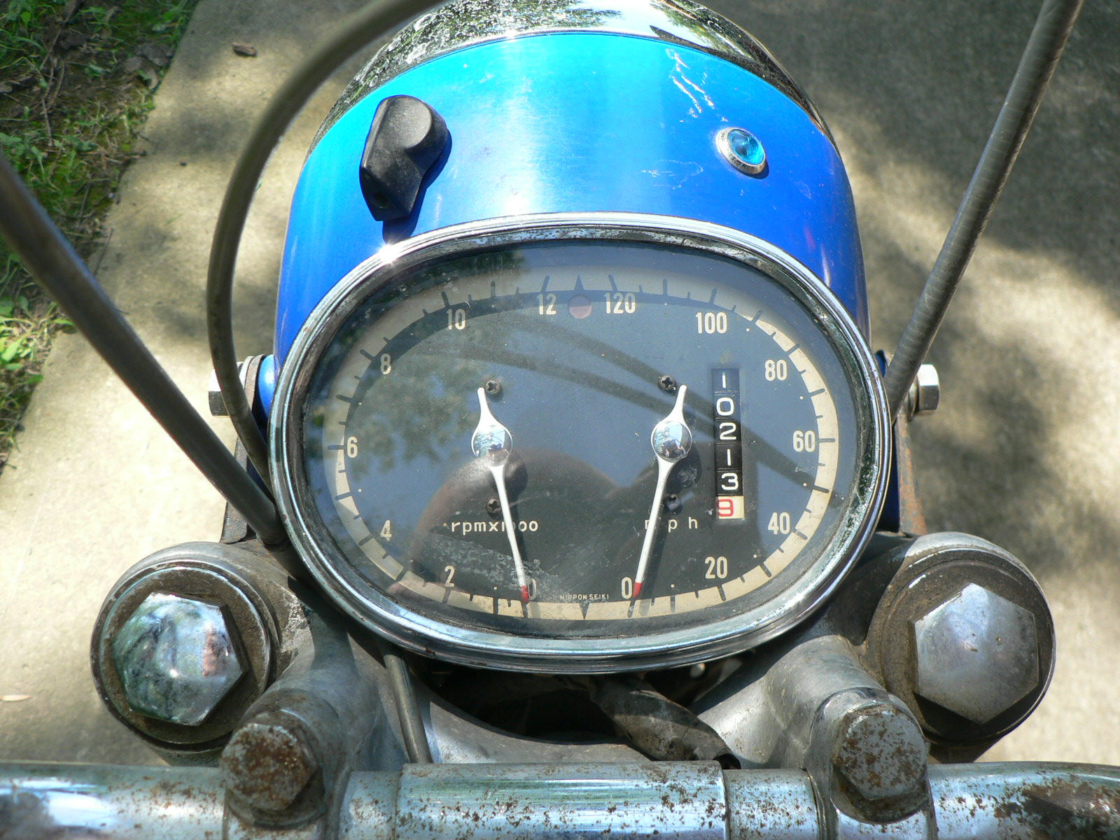

first of all i would like to say thanks for all of the people on this forum for helping me find the right answers. I am still collecting info. I have tried to see if there is a replacement gasket for this speedometer/tach. i have this one 1964: Type Id - Same face as 1962/3, but no "HM" logo on the face. My gasket is there but in very poor shape. I read that someone has made some but they did not say what kind of material or how they did it. so another question of i am sure many more to come for the experts. I will post some pics to show my "progress" of the info i am gathering.

I don't know if our good friend Loud Mouse has any more, but I got mine from him. I have to say that pretty well no one else I contacted had one (Western Hills, Ohio Cycle, Classic Honda Restoration), and they are no longer available from Honda. It's an odd kind of gasket, and I think the one you're looking for is the same as the speedo for my bike (speedo and tach needles going in opposite directions), as the speedo housing is glued into the gasket, and the gasket is attached to the headlight housing with the two little screws on the side. Expect to pay between $70.00 - $ 100.00 for it maybe, if it's NOS?

holy crap! that thing cost liek $2.47 new! mine is there so i may just reuse it. It is in kinda bad shape but for that kind of money i will have to make due. I am definitely on a poor mans restore here. this is a pic of the speedo i have. I also broke the headlight on/off knob trying to get it off. It was pretty brittle but a little pry...i did not see the set screw....and broke it. the insert stayed in tack to i may be able to epoxy it back together, a clean break in 2 pieces.

Yep, that's the one! Mine cost $ 70.00, but as I say, it was NOS and in beautiful shape. You could possibly try to refurbish it with some black gasket maker (comes in a tube and you can get it at Pep Boys).
