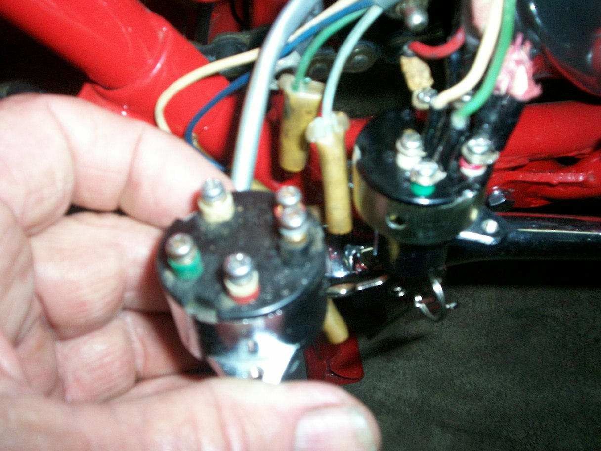

this bike has been sitting up for two years but ran fine when parked .Now there is no power going to the lights or the horn the bike has only a kick start (no electric start) CL77 1967 model.
I can jump the contacts on the rear of the switch and all lights and the horn work.
anyone else have this problem?I have done a lot of work to the bike and the wiring could I have left off a ground somewhere?seems like I would not be able to jump the contacts and get fire unless the switch is bad. need some opinions.
Thanks
switch problems CL77

I order that switch from thailand and it came today .it is exactley the same as the one I took off and it acts exactly the same way????
I have rechecked every wire on the bike and have found nothing wrong but I can still jump the red wire and the black wire on the back of the ignition switch and everything works lights,high and low and taillight and the horn and it is getting juice to the coils and brake light but the switch won't connect them. I just know it is not 2 bad switches. any more ideas?

all wires are to the right color on the switch .
Here's the old switch and the new one hooked up beside it and the contacts on each one were installed at the factorywith the colored markings there are 5 contacts on each one and when the red wire and the black wire are connected together everything works but only from the back side of the switch.also there are no wires inside the headlight getting fire from the switch?
