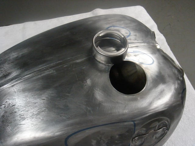

I have a CL77 tank that was all boogered up. Bought a weld in bung and going to re do the whole thing.
Something to think about. Careful with the welding sparks though :)

Flush the tank once with tap water; twice if you're unsure. Just fill it to the brim in a sink or with a hose and drain it; it's the fumes that initially ignite and then cause the liquid to combust, not the liquid itself. The water will purge the fumes. You'll still be able to smell the petrol but, as you probably notice, you can smell it on your hands for hours afterwards, no matter how many times you wash them!
Once the repair is finished, purge the water with about a ½-pint of WD40 (you can buy it in non-aerosol containers -- try marine suppliers; marine techs use it in a plant-type sprayer for winterising engines): bung both exits, pour in the WD40 (or similarly-superlight oil), cap the tank and give it a good slosh around. Do it twice to ensure the purging of all traces of water -- you don't want that in your carb(s)!
Gas-up & go..... The motor might smoke a tad for the first tankful.

I was giving caution to the original poster in case he wanted to attempt a new bung. I did all that before cutting the old bung out of it.
Good advice for everybody.
This one is already welded in place. I will pressure test the whole thing before paint and finishing.
On another note: To pressure test the tank, I took a 1/8" X 1" steel plate and drilled 3 holes in it to match the petcock holes. I then took a section of bicycle inner tube with the presta stem still in it and put the stem through the center hole and used the 2 outer holes for the bolts. The rubber makes a natural seal and it is cheap. You can put a non venting cap on the top and use the bicycle pump to air it up without a compressor or risk blowing the tank apart.
