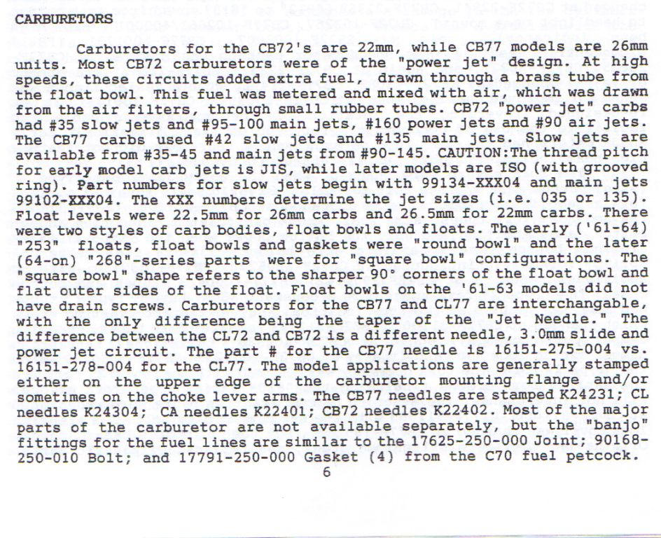

BTW Scott, yours are the late '64 square-bowl type, identical to my '67 pair that I now run. And they have ISOmetric threads, not the earlier JIS*. *Steve's correction from Ed's knowledge base: it appears that this is incorrect -- all carbs have JIS jet threads.

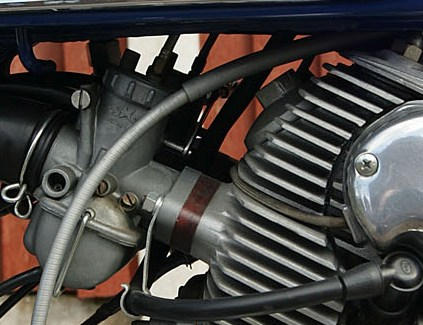

and the attached pics are from a colleague's genuine '61 CB72, which, of course, are Power Jet types. Click this link for Honda's shop manual overview: http://www.honda305.com/forums/viewtopic.php?t=3461

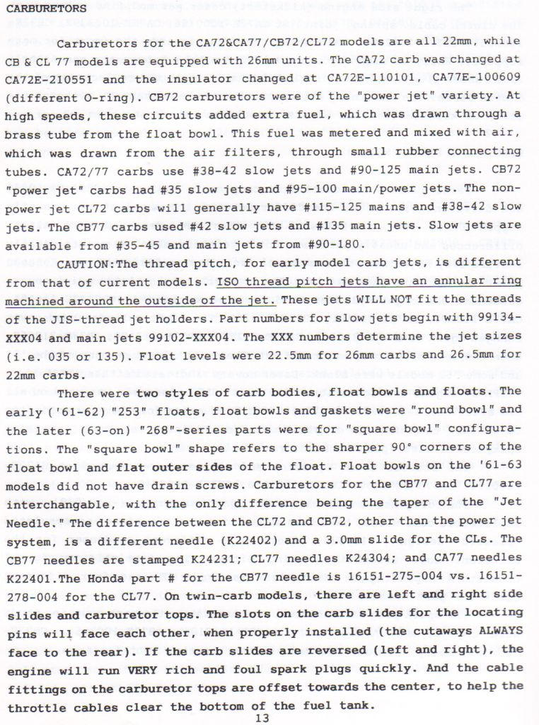

Guys, it appears that some of the info within Bill Silver's publications' pages, which is predominantly my info source, ain't always entirely pukka; Ed kindly PMd me with this info:
Honda's shop manual carb overview here:
- All of these carbs used the JIS. Also the NOS carbs being offered that you show came around/about early 1966. The square bowl type before that had the castings for the power jet system which was not used on any CB/CL77 carb issued to the US sometime 1964 thru sometime 1966. I know you read all of Bills info but at times he isn't totally correct. For instance the round bowl carbs changed to square sometime in 1964. First square bowls were changed to last issue sometime in 1966 but there isn't any data as to what actual engine numbers. His statement "current models" doesn't include these carbs but carbs issued for other bike models that came later. The round bowl carbs on your friends bike are the Power Jet issue. There is a way to tell which engine a 26mm carb was issued for by comparing the way (26) is cast on the mounting flange. I'm a grease hand and some printed data doesn't agree with what was actually assembled by HONDA over the years. ....................lm
