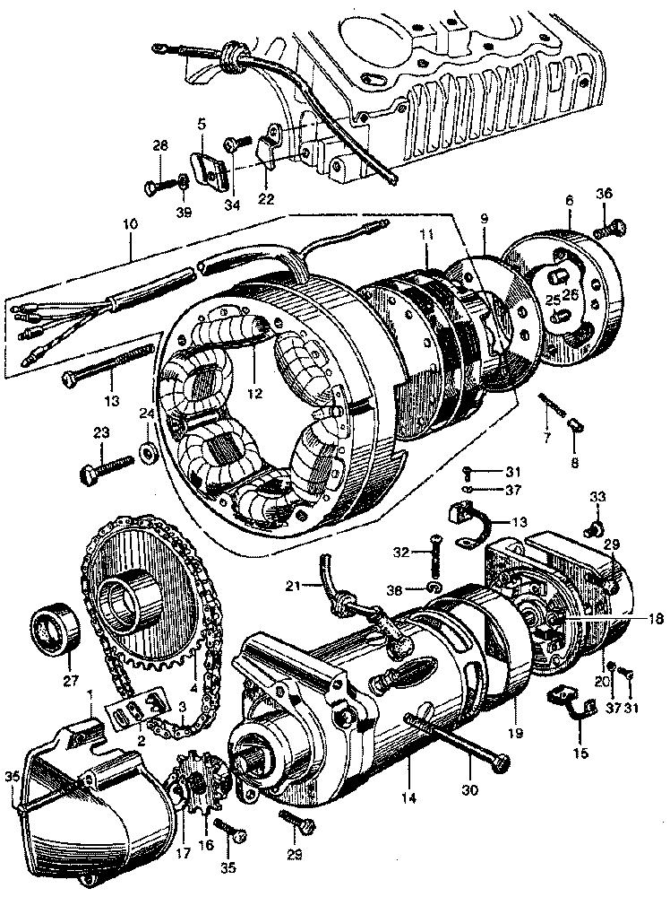

Electric starter problem:
I have had intermittent problems with the electric starter since I rebuilt my 1966 CP77. A year or two ago, the starter would work:
If the engine was warm.
If the battery was fully charged.
If it felt like it.
Now it won't start unless I kick it.
I have read previous posts about a starter clutch, and springs wearing out. I can't find any information about where the starter clutch is, and where I would go to replace the springs. I have replaced the engine clutch plates, and they work fine. I assume that the starter clutch is on the other side of the engine. The electric starter spins the chain just fine, it doesn't spin the engine. Does this require major surgery to fix?

It is behind the rotor. ................lm

Terry, it sounds like you need new starter clutch rollers, springs and possibly plungers. It's a doddle of a job; let us know.
FYI, WHHY have (or at least 'had' a couple of month back) the items in stock:
http://www.westernhillshondayamaha.com/ ... detail.asp
ROLLER (10.2X11.5)
91101-377-000
SPRING
28125-253-020
CAP
28126-253-030
3 of each, cheap as chips! parts@westernhillshonda.net
