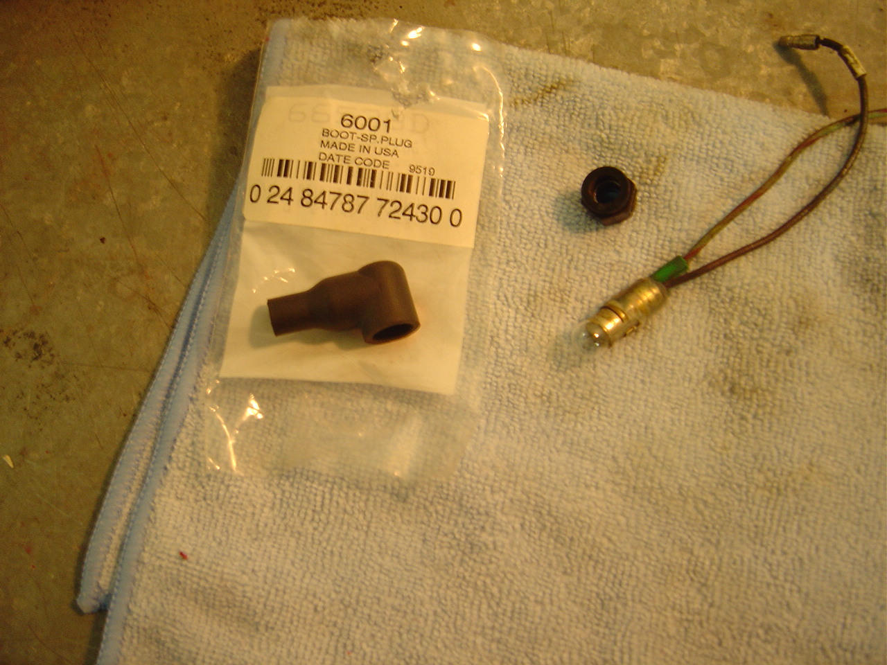

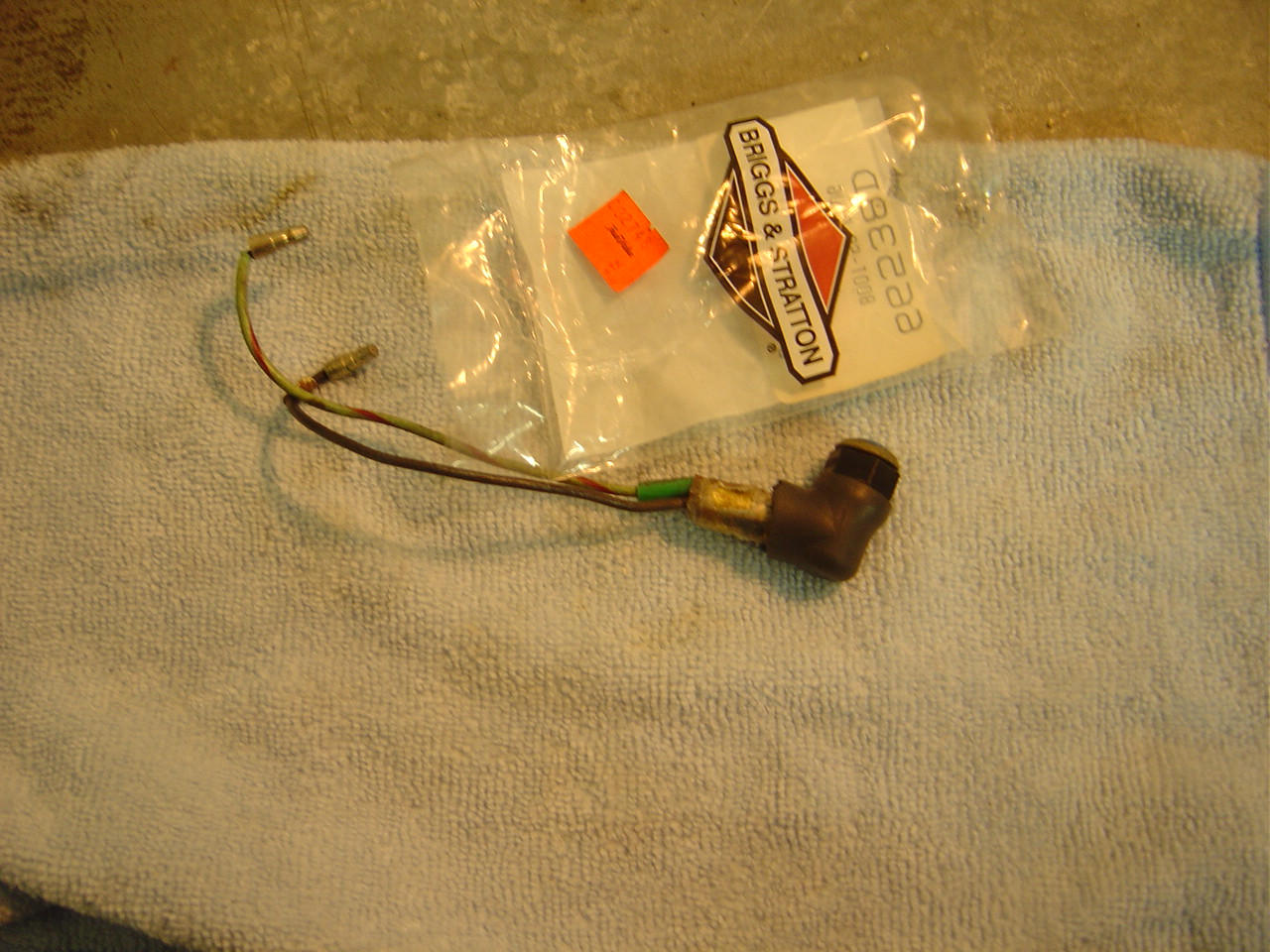

This Will Work
I was in True Value Hardware and spotted the lawn mower spark plug boots costing a grand total of a $1.99 each. With a little trimming fits better than the glove did on OJ.
