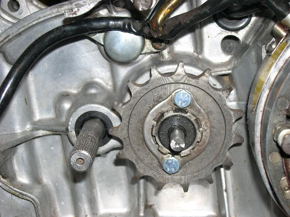

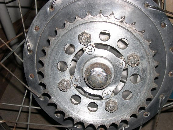

I'm putting together one of my final (doubtful, but I'm hopeful) parts lists for this rebuild, and am wondering if these sprockets need replaced when I replace the chain.
Also, I've x'd the gears, and am wondering if the current 15x32 ratio will still be optimal for in-town and twisties riding. The motor was seized when I took possession of it, so I have no idea what to expect, performance-wise.
Advice appreciated. Thanks!
Andy

305explr, Forget that rear sprocket,its toast. I think its best to replace both sprockets and the chain at the same time. That goes for any chain driven cycle. I don't have any experience on the trans Xing the gears,but I thought that the 4th gear remains the same. If that is the case then 15/32 would be OK for regular riding but if alittle more acceleration is desired I always liked the 38 T rear sprocket you would normally find on a CL. You will need a longer(just a link or 3) chain. Or if you want to get radical, drop one or two teeth on the front sprocket. It will cause you to suffer on top end MPH but it sure gets you started. Kustommusic

Both are shot and stay with the same ratio. ...............lm

Absolutely agree with Kustommusic's and LM's obs: the rear is ready to be passed on to some budding Ninja. The front would be OK, at a push, if you invert it; but old sprockets will ony serve to accelerate wear on a new chain. I'd always suggest changing the entire sheboodle as a set.
