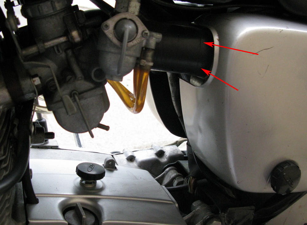

My air boots have some minor cracks near the filters.
How much with this effect my mixture and has anyone come up with a good repair technique?

Re: Here's a shot of the offending boot.
They will be OK because there is a steel liner in those tubes. .............lm
Fastwater wrote:What do you think? Repairable?

Re: Relieved.
When ya can see through the piece and then some folks use black vinyl tape. .............lm
Fastwater wrote:Brilliant. Thanks LM!
Is there a certain point at which they will HAVE to be replaced?
Something I should be looking for?
RIDE IT DON'T HIDE IT!
