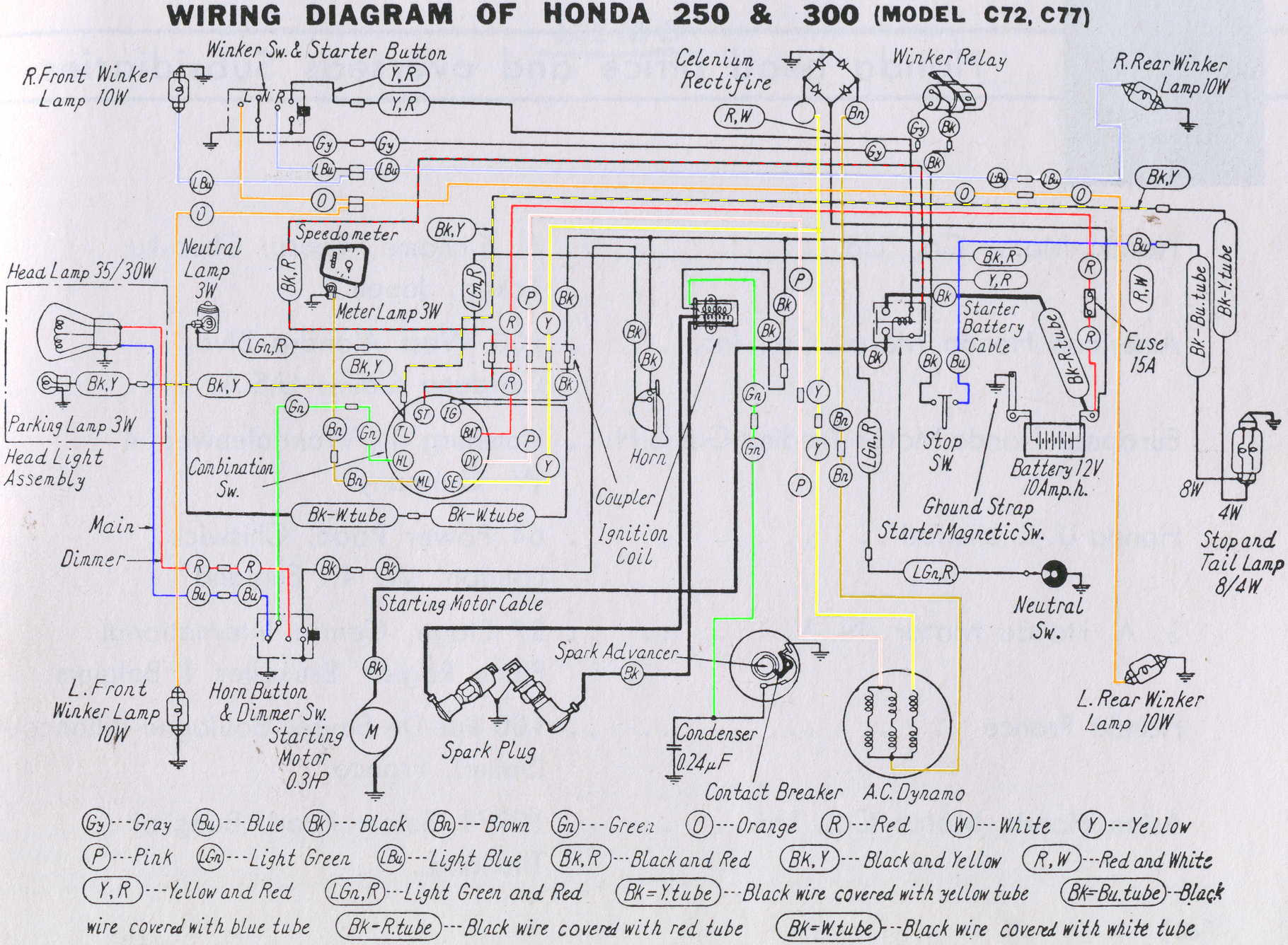

I have a CA 77 1964 and the hose that I have connected to the top vent on the motor has some oil coming out of after I ride it, not alot but enough to make it drip. Also I am not receiving any voltage back to the battety, Same voltage at battery when motor is running or not. I guess the stator is bad. How can I check it? Do I have to remove the whole right side engine cover to remove the stator or just the round cover ? Thanks

to check the power coming from the stator put your multimeter across the yellow and brown wires that connect to the rectifier (they are that color on mine anyway). the other two wires on the rectifier should be "black to earth" and "red White" to battery. Put the multimeter across these wires (at the rectifier end) to see if the rectifier is working, it should be putting out a touch above 12V
Stator’s rarely “brake” usually they kind of fade away as the magnets lose their effectiveness (in my experience anyway). I would work backwards from the battery with a multimeter making sure that all the wires are connecting properly and that your voltage regulator is still working.
I replace all the old voltage regulators with a solid state one (plenty of topics in the forums about this) and keep the old one in place for looks. The new regulators give 30% more power to the battery apparently.
Do you need a wiring diagram?
