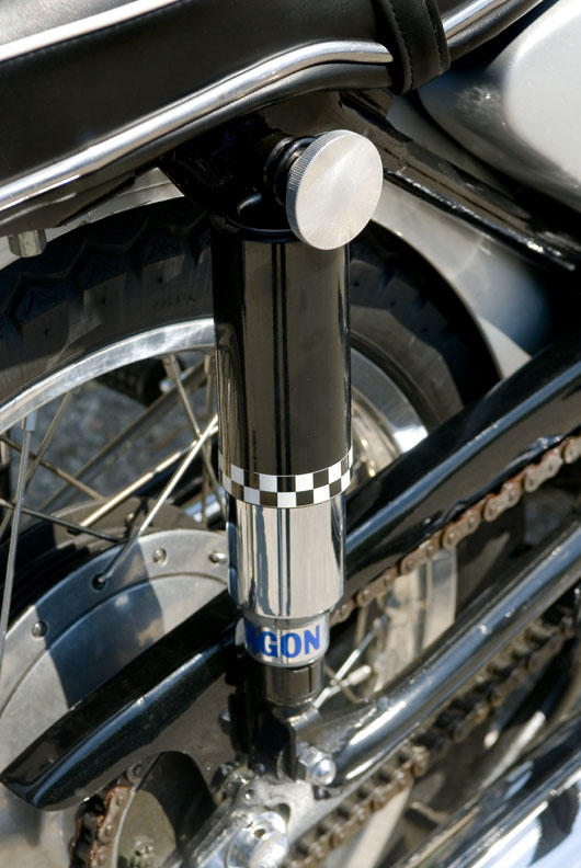

Don't know if they've changed their characteristics, but I have those Hagons on my bike and they're perfectly fine. As well, I just checked them to see if there's anything unusual about the manner in which they were mounted, and it all looks totally normal to me. The only thing 'different' that I've done is replaced the upper acorn nuts with Norton seat knobs, and put the acorn nuts on the bottom, but that doesn't affect the rest of it.
I bought these shocks about 4 years ago from Dave Quinn (dealt with him directly), so unless they've changed since then I can't see what the problem might be.
If you need me to take a few photos for you, I can do that and post them.

Haven't shot anything new yet, but here's a photo that I did a while ago in the meanwhile.
Can't you just find chrome washers that are large enough to prevent the upper mount from sliding off?
My solution with the Norton knobs is admittedly a bit 'different', but before this I had them mounted 'normally' and they seemed fine.
