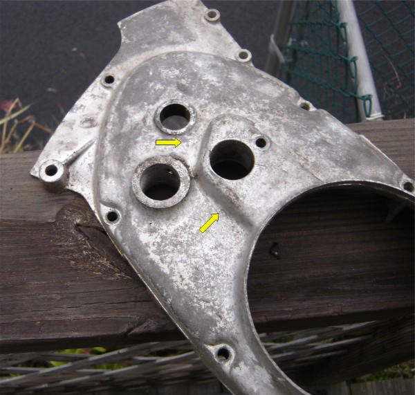

Block, how bad is the crack? It can't be welded and refinished? I have one that has a hairline crack that I was going to weld and polish up outside and web weld inside to reinforce around kick hole. Just a thought.

well, I guess I got some kick in my leg! That and a lot of no starts while trying to get this thing roadworthy. I did JBweld it back together as an experiment and got my clutch back. Sure isn't kick worthy though. Hopefully I can get it going reliably enough that no kicking would not be an issue.

That's looks a little more than a good sized crack, looks like it's history. I have one that has a crack that you would have to know where it was to find it, it's that fine of a crack. Like I said in previous post it can be electric welded and finished off on the outside and spider welded inside and if you have a starter working should'nt have to kick it. I'll post a pic tomorrow.

Hi Block, heres the pics, crack is between arrows. camera not real good. I think this one can be saved if you know anyone who can weld alluminum.

Doesn't look bad at all. please send me an email in regards to what you want for it, etc.
