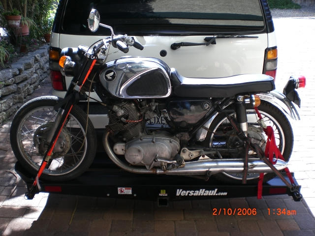

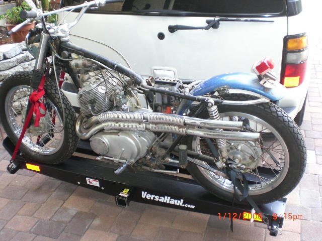

Thank's guy for getting me hooked on old Honda's .Worked for a Honda shop as a kid , in the 60's Since I founed this forum and the help from Loud Mouse,Davomoto and mike mullen for the beer exchange for parts program ,have been a great help.I have been looking for an not found a PPG code for Paint colors,Know I came across it some where on this forum but just cann't find it.Thought I'd send along Some Pictures of some arrival over the last few months.Tom
