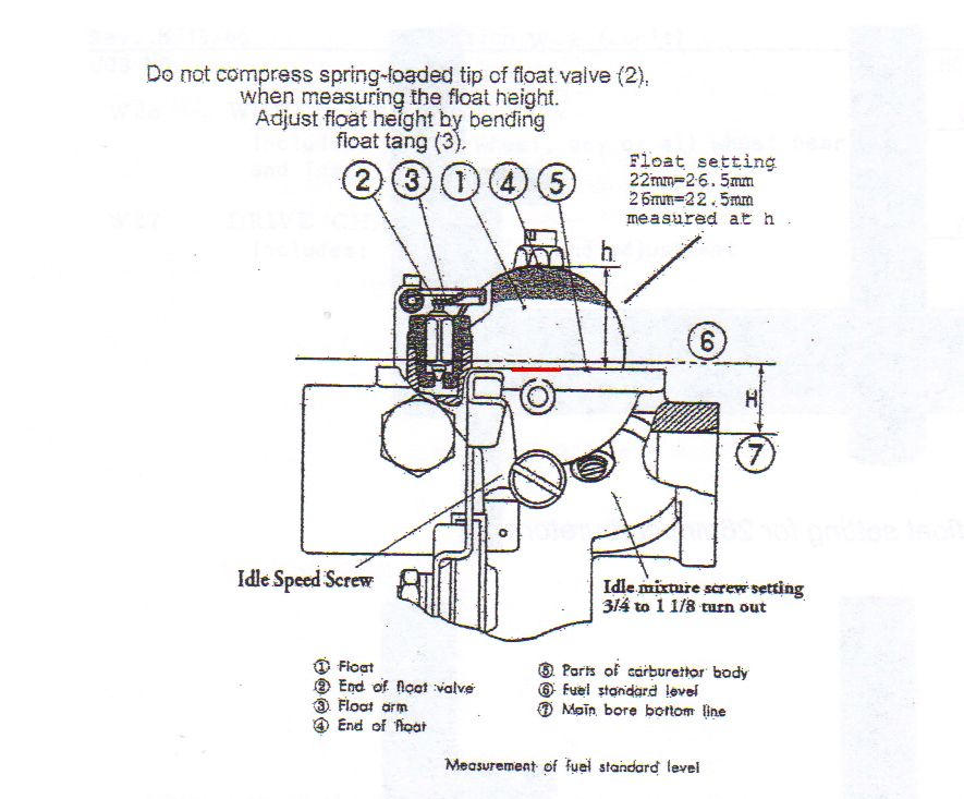

I had a number of issues just like yours, which turned out to be related to my float height. A combination of them not being measured EXACTLY right and the tang being bent in an odd shape, and therefor not depressing the valve needle correctly.
Make sure to measure 22.5mm EXACTLY from the dip to the top of the float as it's just touching the needle, but not depressing it. There's a small dip along the side of the body. Make sure to RE-TIME after adjusting the float height.
P.S. Also check to make sure the floats aren't getting stuck on the rim of the gasket. You can bend them inwards just a bit with your fingers.

Float height setting
Yep critical alright. I attatched a piece of fuel hose to the inlet so I could blow air in the inlet(w/ my mouth) so I could tell exactly when the needle and seat would stop flowing fuel.No question they are right on w/ this method.
