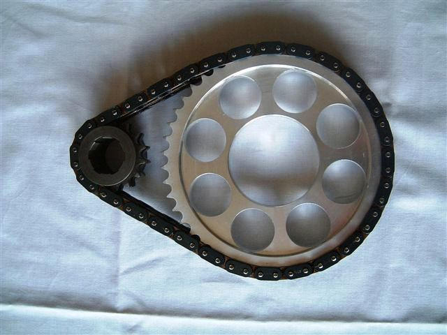

Post by hondauser » Thu Feb 18, 2010 8:27 am

Post by LOUD MOUSE » Thu Feb 18, 2010 8:57 am
How is it attached to the clutch basket?. ..........lm
hondauser wrote:www.mpe07.co.uk/prod04.htm a look at this

primary transmission
Post by hondauser » Thu Feb 18, 2010 9:23 am
how is attached the original one ??
==== fixed by rivets /// rubber-blocks in the holes and closed by metalic plate
this is the original fitting !!

Post by teazer » Thu Feb 18, 2010 9:43 am
Bonjour MK,
Very nice. that looks like Oily Tom's work from MPE in the UK.

but it is MPE
Post by hondauser » Thu Feb 18, 2010 9:50 am
yes !! www.mpe07.co.uk/prod04.htm
MPE make it
and i want to know the cost of it !!

Post by LOUD MOUSE » Thu Feb 18, 2010 10:50 pm
So this will mount the same way as the HONDA sprocket does?. ......lm
hondauser wrote:how is attached the original one ??

Post by teazer » Fri Feb 19, 2010 1:21 am
Yes. The engine sprocket fits straight on and the clutch sprocket has to be rivetted or bolted in place.
The duplex primary chain is much stronger than a stock chain and probably a whole lot more available.
That looks like a copy/update of the duplex drive supplied by Dennis Murfin or Tony Milk years ago but may be a new design. Oil Tom has a great reputation in the UK for his gears.
We were going to have him make up a couple of gears for a BMW1200RS, but R&D in Clearwater were able to weld up the dogs and undercut them more economically.
