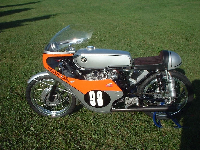

Well it's worth a try, I know that i got a CB200 5 speed into my 1964CB160 4 speed casing and it went in with very little problems

Actually it was a 175 tranny I thought the 175/200 was the same, but a little fitting and it went in
Bert
Finished Article
Finished Article
