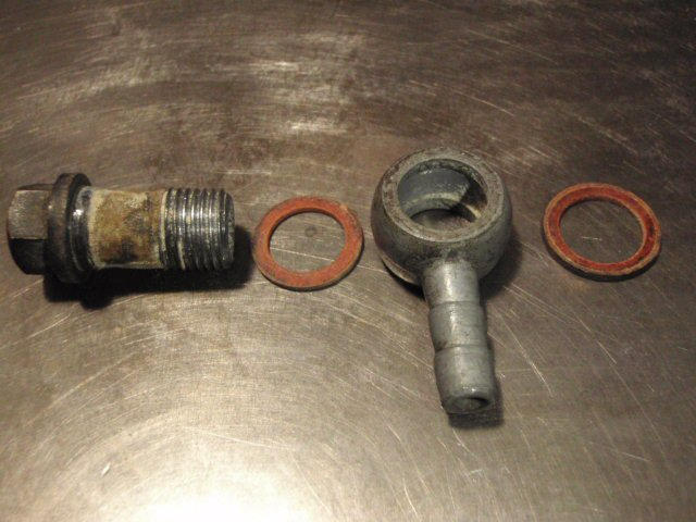

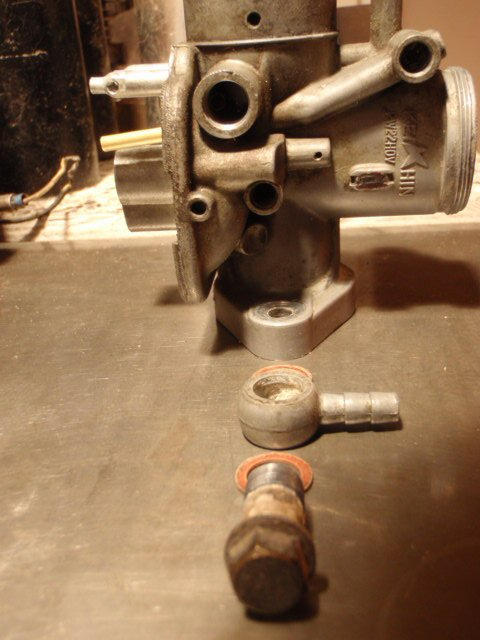

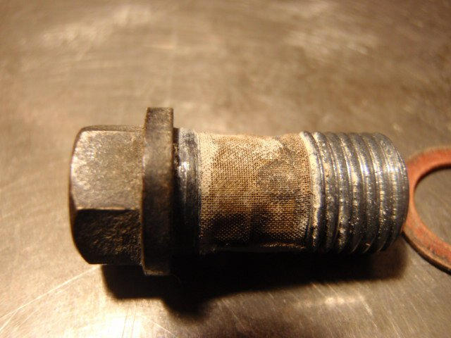

jensen
Posts: 1143
Location: netherlands, huizen
Post by jensen » Thu Apr 15, 2010 9:15 am
Hi,
Correct me if I'm wrong, but there is a fuel filter installed in the left and right carburettor, standard.
Are these filters not working properly ?
Jensen
toastyhamster
Posts: 153
Joined: Mon Aug 18, 2008 3:17 am
Post by toastyhamster » Tue Apr 20, 2010 12:50 pm
In the carb itself? Don't think so. There's a gauze in the tap but it doesn't seem to be doing the job.
jensen
Posts: 1143
Post by jensen » Tue Apr 20, 2010 1:43 pm
Hi,
Yes, where the tube is attached to the carb, screw that bolt out, and you see a filter around the bold.
Do I have to take pictures for you ?, I'll be glad to help you out,
Jensen
jensen
Posts: 1143
Post by jensen » Tue Apr 20, 2010 3:37 pm
the pictures
