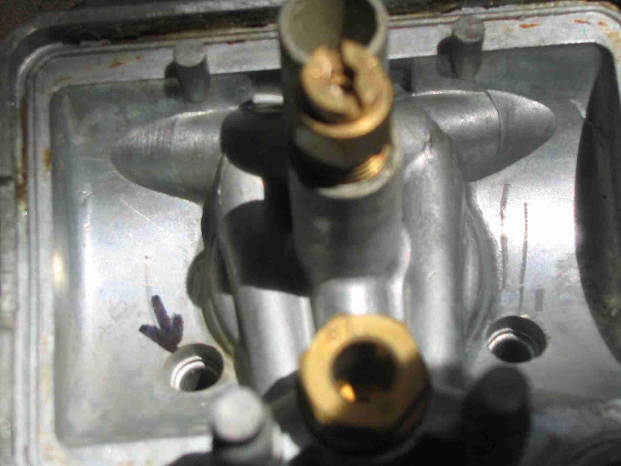

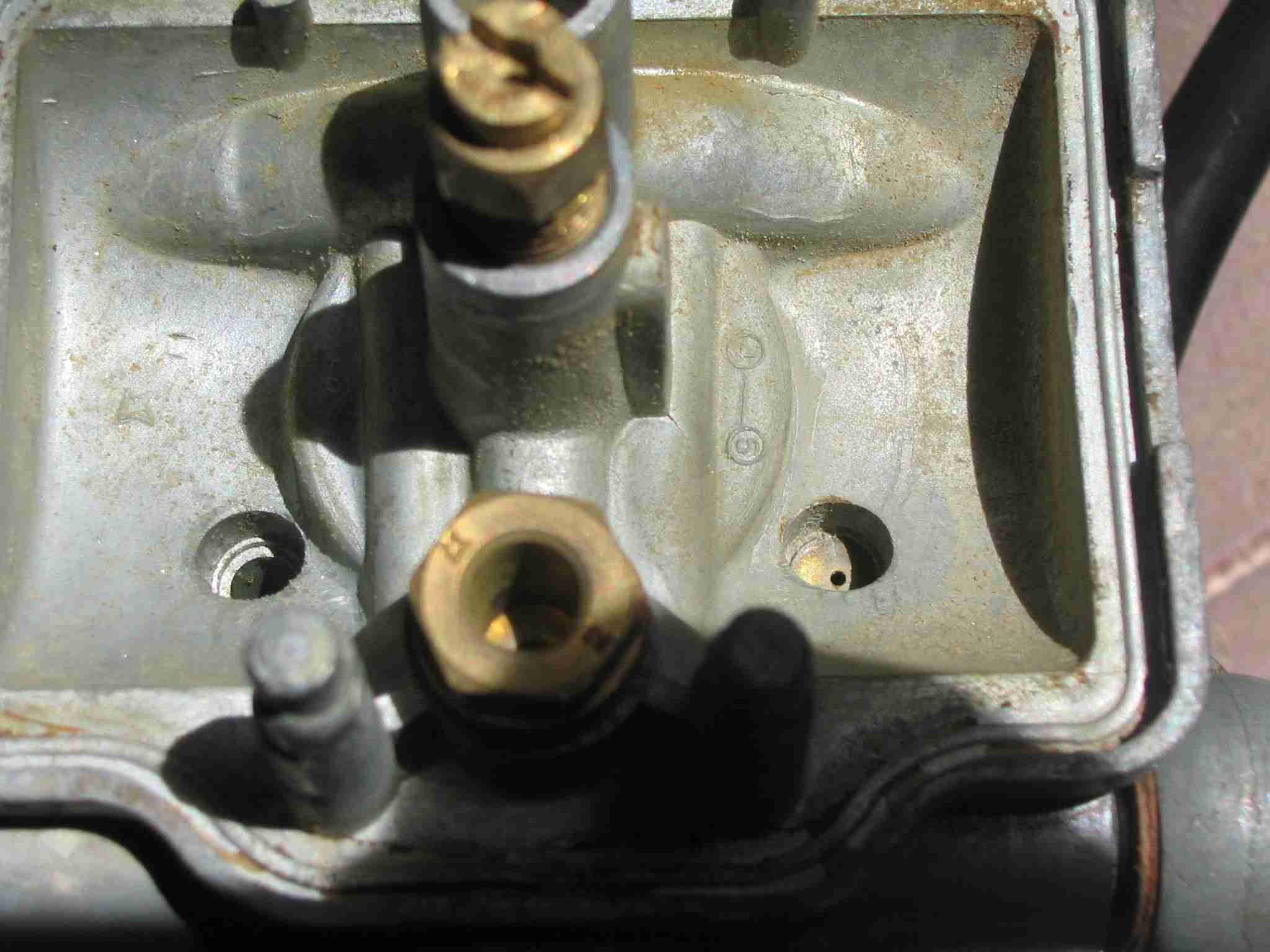

I have a pair of Keihin cl77 carbs off my '67 cl77. They are stamped with a '26' on the side. On the top side of the float bowl there are two large wholes. One has a brass insert with a small hole inside. The other has no insert. The whole exits on the side of the carb. Is this just a vent for the bowl and do I need to find an insert for the other carb?

Both carbs need the insert.
If not there ya may expect to have a wet side on the carb. .........lm

But there is only one brass insert (vent) per carb. You don't need an insert on both sides of each carb. jwb

Post by LOUD MOUSE » Wed Apr 14, 2010 9:58 pm
Yep.
That's what I offered. ..............lm
"need the insert."
