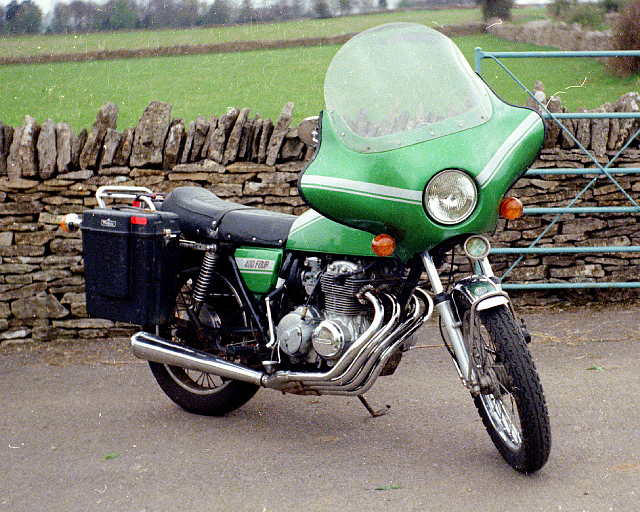

That's good to know. I managed to cram a Hell H4 halogen reflector into my CB400F headlamp. Had to cut a hole in the plastic headlamp shell to let the pilot bulb holder poke through though....
My CB400F also ran a Lucas 3 phase rectifier when I found out that it cost about 1/4 the price of a new Honda one. I did 14,000 miles on my bike in the first year. Pretty reliable apart from burned-out rectifier, arcing (in the wet) plug leads and rusty front fork stanchions. Those were the days!
About 1978
