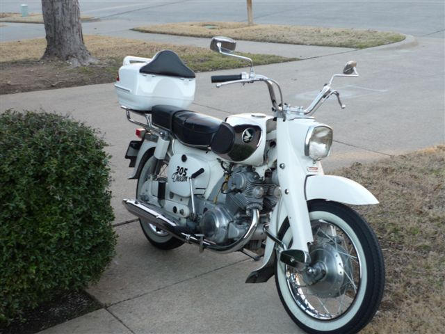

I've often wondered about the maximum top speed for my 1966 Dream. Still not sure what that would be, but I did hit 80 for about a quarter of a mile flat strecth with about a 6 to 8 mph tail wind. I'm a slow cruiser by nature but this made me feel pretty good being that the manual for these bikes idicates 87 as top speed when they were new and rifght out of the box. Just wanted to share that with you guys! The attaced photo is the bike I was aboard.
Well, that's about 5 mph braver than I've been on mine. I haven't had the inclination to try to push it any faster than that. Much about 60 and I stop feeling comfortable on the Dream. It doesn't feel dangerous, just not comfortable. That said, it loves 50-55. Feels like it was meant to go that speed. Nothing faster, but I also have a hard time going slower.
By the way, that white looks really sharp - especially with the tires. I was very tempted to repaint mine white (the original color). Have gone back and forth between being happy with my decision and sometimes not. The white makes the Dream stand out in a crowd of already distinctive old Hondas. Perhaps the only solution is to get yet another and have a checkered pair.

Yes Jeff, you and I are not that different about speed. My bike cruises effortlessly at about 60 and I very seldom exceed that. I got seduced by the temptation of wide open highway with no cross streets and just decided to go for it. Also, I appreciate the compliment as I have always been partial to white every since I was a kid and my brother drove a white sport Honda 50. It does get a lot of attention when I take her out as I'm sure yours does as well. These are very uniquely stylish bikes!

Rob;I have found that a 305 dream with a fresh engine on level ground will easily hit 80mph indicated(for what thats worth). I have also found that those Coker tires on your bike will scare the Bejeesus out of you at about 50mph. get some Cheng shin's 289's, new air cleaners, rebuild the front end, and go out and carve some canyons.
