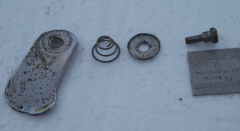

On my newly-acquired C72 project and its parts bike sister - it is a screw. There's a little spring there too to give the cover a little movement. I'm on one of my US trips at the moment but I'll willingly measure it for you when I get home to UK (23rd May).

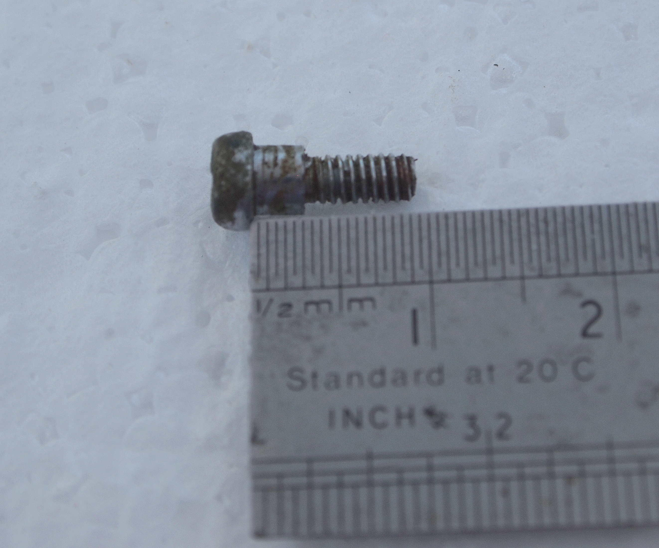

As promised, here are some details of the lock cover and screw.
Diameter of thread 3mm (measures 2.86)
Length of threaded portion 6.24mm
Diameter of boss (under head) 4mm (measures 3.95)
Length of boss 3mm
Head diameter of screw 5.66mm
As for thread pitch, I guess that it will be JIS, so same as tank badge screws.
Complete assembly
Complete assembly
Screw dimensions
Screw dimensions
