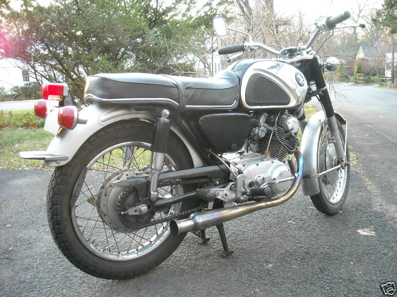

I got a flat the other night and had my bike towed home. I ordered a new tire and need to remove the rear wheel so that I can take just the wheel into the shop where they will install the new tire.
I have not yet tried to take the rear wheel off but once I do try, what things should I consider? Exactly, how should I go about removing the wheel? Is it a very tricky process, I did notice that I will have to work around the chain?

It's a piece of cake. Just start by loosening the adjustment screws on the end of the swing arm. Then, remove the cotter pin from the castle nut on the axle rod. Pull the axle rod out and move the wheel forward so you have enough slack on the chain to remove it. After that, just slide the wheel out.

Take your time and there's nothing complicated. On the CB, the axle is really close to the mufflers, and you may have to remove one or both to get enough room to work.

Awesome you guys! I just got the back wheel off with no problem. (Boy that tool kit the bike came with is priceless). I appreciate the responses and while I am a little weary of attempting to change and balance the tire myself, youtube is a powerful tool and I just may see what I can't learn from there and perhaps do it all myself.
