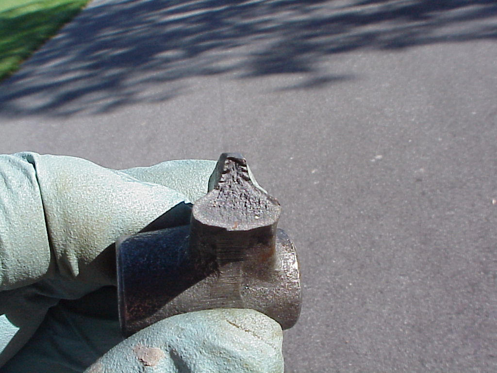

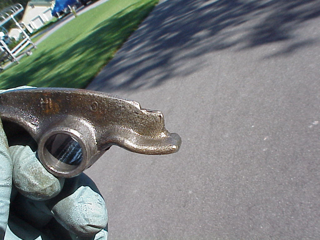

First thing I found as a broken rocker arm. It is the right intake and it broke just behind the adjuster where the arm itself begins at the adjustor boss. Looking at all the arms, it appears that when the flash was ground off the casting at the factory, the guy doing it was new, blind or drunk. He actually cut notches in the upper web of the arm. Not all the arms were like this, but at least two have severe notches. At first I thought it might have an aftermarket cam and needed some relief ground in them, but I don't think that is the case. There was a small notch right where it broke. Nice stress riser.

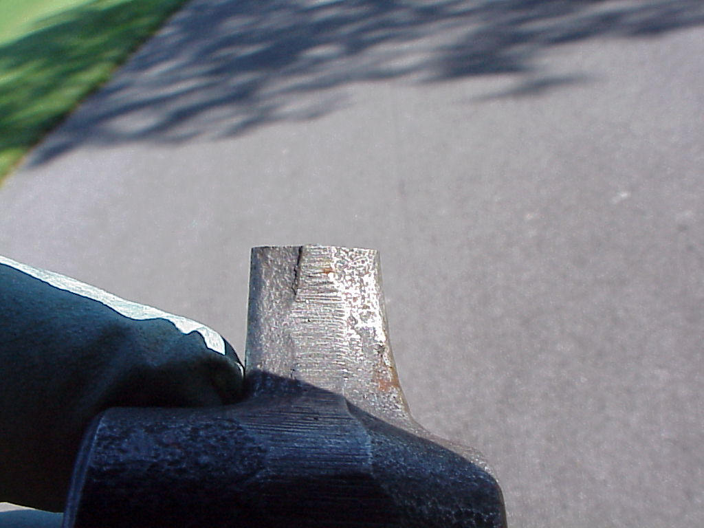

Here is a pic of the broken rocker arm. Note how coarse the grind marks are where the casting flash was ground off. Also note the notches ground on the cam side of a couple of other rocker arms.

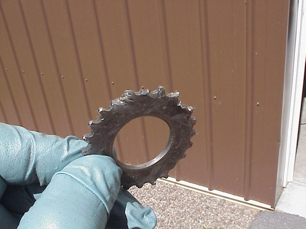

I found what I think is the primary culprit in what might have killed this engine. The nut holding the oil trap drive sprocket to the crank fell off. No sign of the tabbed lock washer so my guess is reassembled without it. Sprocket worked its way off the shaft and got chewed up in the process.

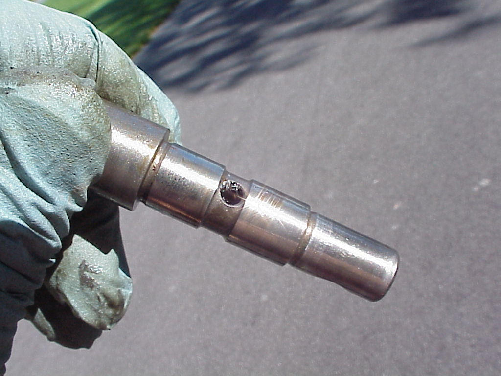

I found metal chips in the cross-drilled oil holes in a couple rocker arm shafts and this is probably where it came from. Also found similar chips in the keyway cut in the clutch throw out cup. Probably not the correct Honda term, but just learning these engines.

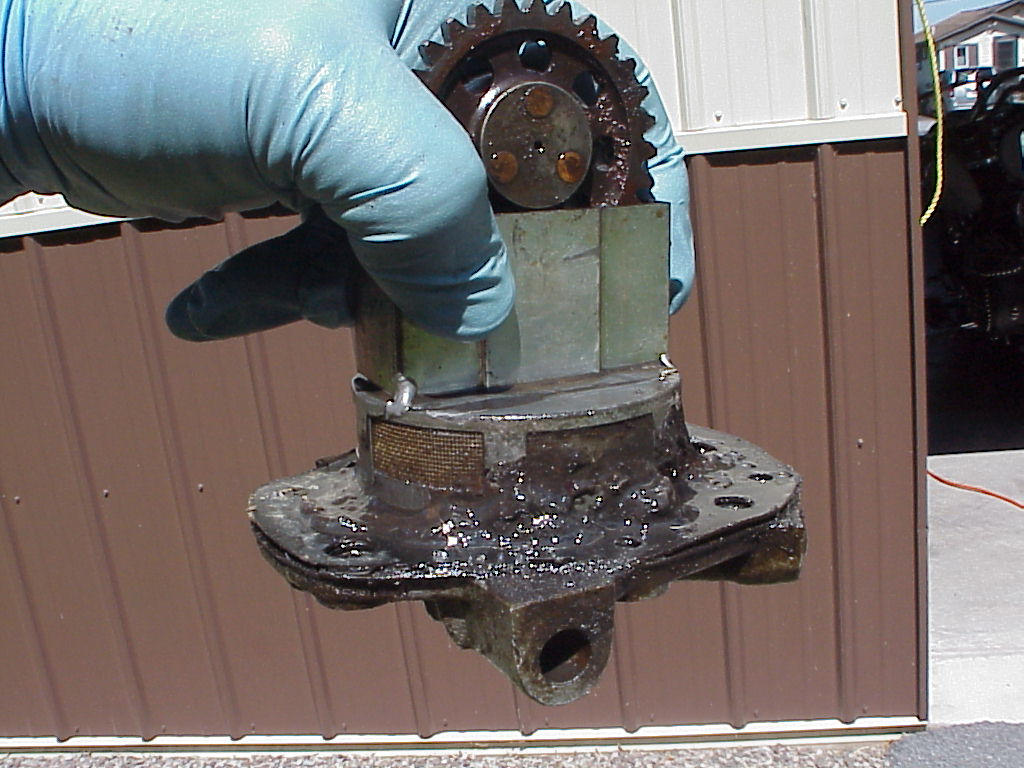

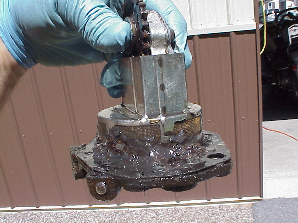

Lastly, sump screen around the oil pump was about 50% plugged with sludge. Very nasty looking. Definitely has given me the incentive to drop the pump from my bike to check for similar deposits.
Most of the slugdge in this engine is not hard. It is soft, almost grease-like. I'll post pics in succeeding emails to show what I found when I fill up this post.

Fracture surface of broken rocker arm
Notches ground in rocker arm.
Note coarse grinding marks creating stress risers. This is broken end of rocker arm.
Metal chips in oil hole in rocker arm shaft
Oil trap drive gear from crank shaft. Found in sump along with nut.

Oil pump screen and sludge
Post by Snakeoil » Sun Aug 29, 2010 12:54 pm
Here are pics of the oil pump screen.
Reason enough to drop the oil pump on a newly purchased 305?
Sludge wrapped half way around OD. I figure about 40% - 50% plugged.

I suspect the nut and sprocket came off and the owner just kept running it. Broken rocker finished it off. The end of the valve stem opposite that rocker is beat up compared to the others. I'm thinking he had way too much lash and it beat the rocker until it broke.

That sludge looks almost like a quart of castor oil added to the mineral oil. I recognize it...
Or it could be old style BelRay which was more like gorilla snot than oil.
That sharp notch in the rocker arms is stock. I have always speculated it was a locator for manufacturing /grinding the faces. That failed from a huge hit and probably too much lash or a bent valve from a broken cam chain wheel. I had that happen a few times.
