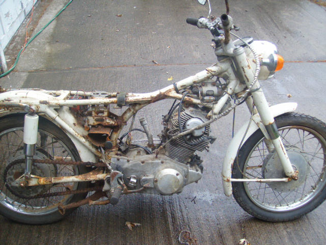

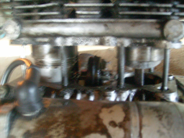

Post by shooter_bighorn@yahoo.com » Wed Sep 22, 2010 12:28 pm
ive got same problem i can get one piston out of sleeve but other one hangs up dont wanna beat on it but i get full travel up and down with piston in the bore but one side will not come out of the jug can i take the motor and use a block of wood and tap it with a hammer or to risky?????

Post by bikedoctor99 » Wed Sep 29, 2010 1:29 am
tapping the piston with wood and hammer should be ok. you should rotate the motor so you can spray more kroil between the bottom of the piston and cylinder, also cut or fit a block of wood between the bottom of the cylinder and case to support the cylinder-set the cylinder at a position that will allow the crank to rotate as the piston moves downward. at this time i would let the kroil work over night. reset the motor to upright. when you tap firmly onto the piston, use a soft wood(pine 1 1/2" square will do the trick)you may have to be a bit forceful. good luck!!
