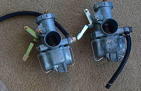

I think cadmium lands somewhere between zinc and chrome as far as brightness goes. I think the most original look would be zinc, though I'm not a real expert on OEM plating. I know the chrome honda did was a cheap single layer "industrial flash chrome", unlike today's show quality triple plating.
In England Cadmium plating is now illegal due to the toxicity of Cadmium, classed as a heavy metal. The choice here is limited to zinc but you can have different passivation to give different colors.
Typically you will see silver (clear passivate) and yellow which mimics what many people call cadmium.
The two carbs pictured are both NOS Honda but with different styles of plating. I have found both colors on Hondas from the 1960s. I don't know what the rules are. I prefer the plain silver look but others will differ...
