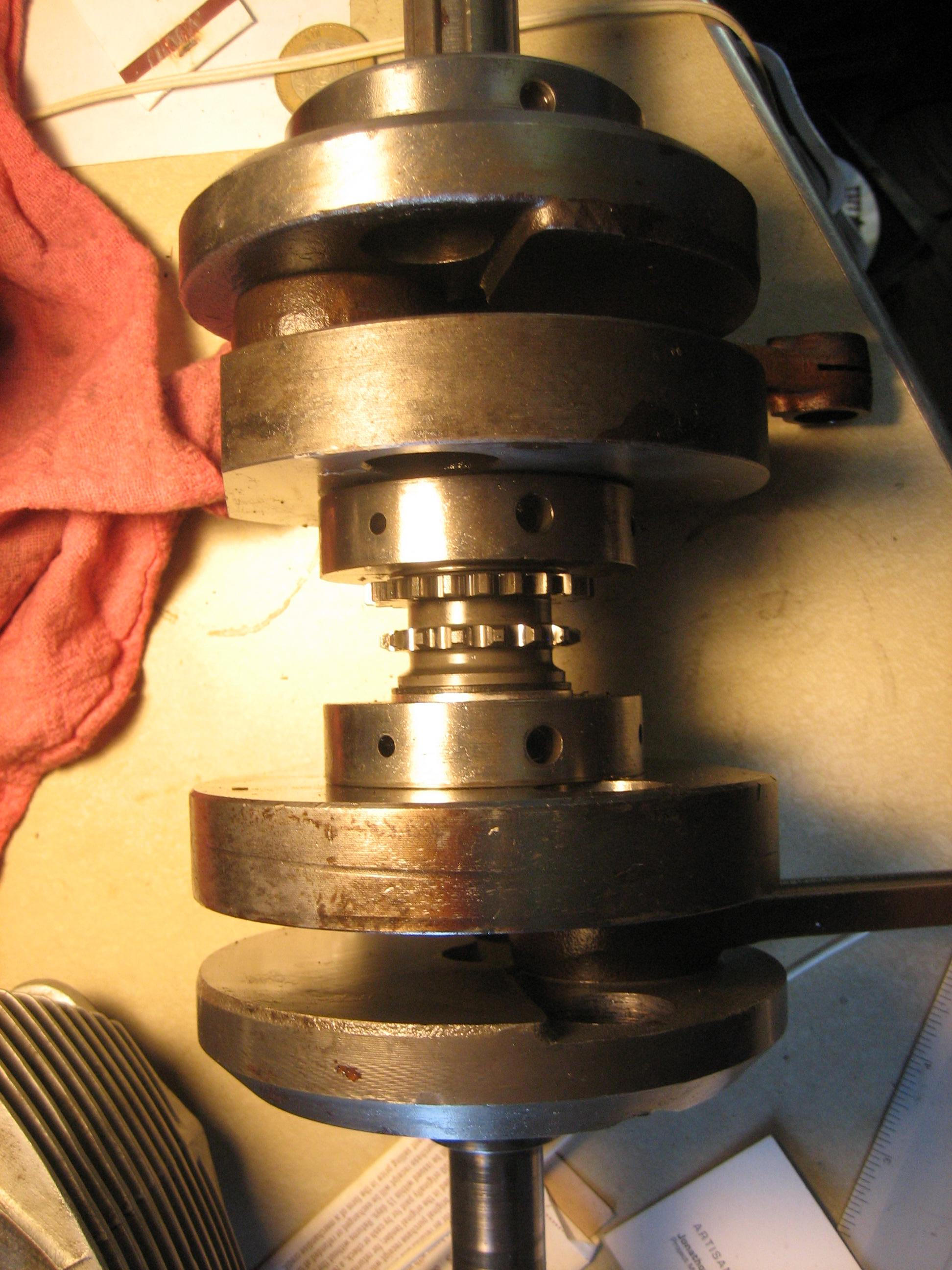

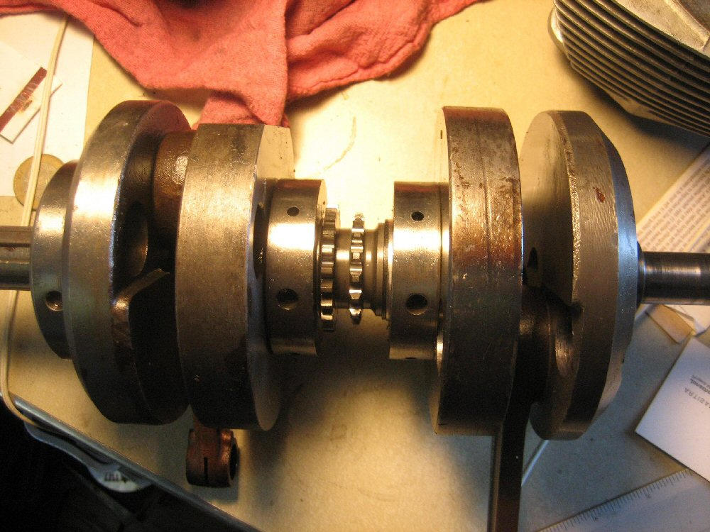

- Posts: 82
- Joined: Wed Mar 11, 2009 11:32 am
- Location: Los Angeles, California
Jensen,
It fell on the clutch side. Cover was bolted on. Squished the shifter pedal into the case a little bit.
I had checked both cylinders dynamically and all was well.
The spark plugs looked fine. Light brown color.
One area of the interior crank weight on the right side shows some bluing. I've attached a photo. The pic is oriented funny but I'm talking about the the side of the crank at the bottom of the photo. I pulled the roller bearing off the shaft on that side and it has some play and a rough spot in it's rotation. What's odd is that this is NOT on the cylinder that I believe failed. I don't know if the bluing occurred at the time of failure either. I can imagine a situation where the bike tipped over (I wasn't riding it at the time), still running (although only for a few seconds), and all the oil moved to the left side -- leaving the right side unlubricated.
