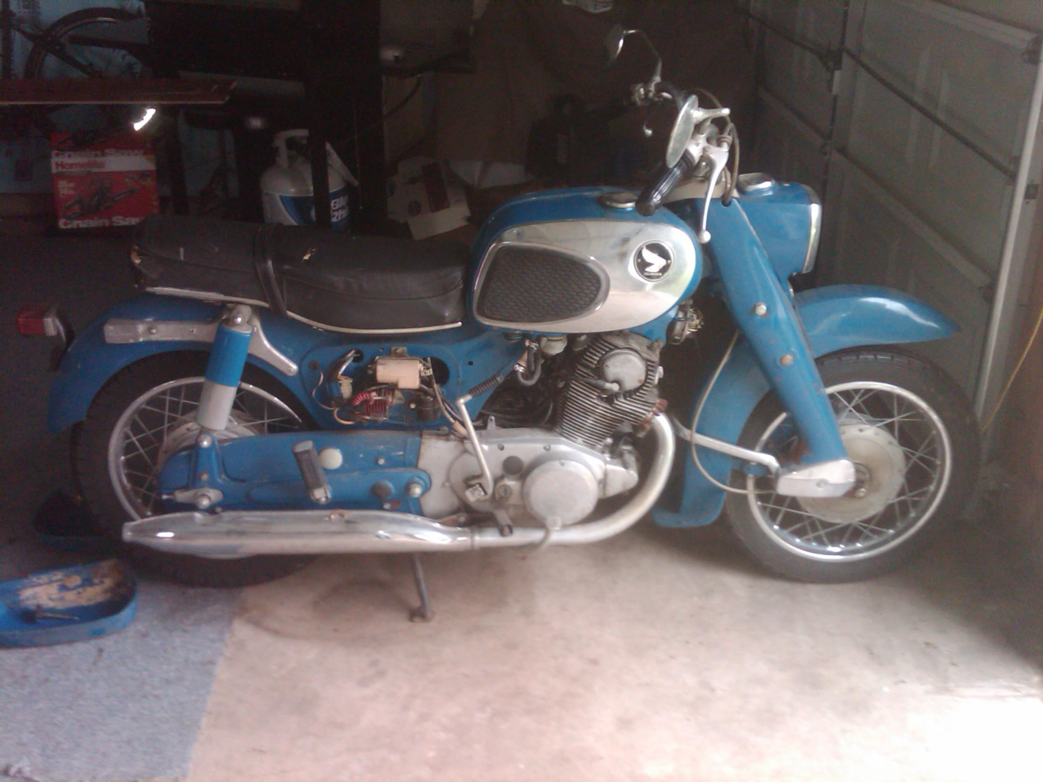

I recently acquired a (not sure of the year yet) Honda Dream. I know its a CA77 from the stamping on the engine block. It was my grandfathers and it has been in a garage for the past 28 years. He recently passed away and I would like to try to bring it back to life. I really fell in love with the look of this thing as it isn't in bad shape at all. The engine runs freely and I believe it won't take much to get it running again. Thats where you guys come in. I'm not that familiar when it comes to motorcycles, but that doesn't mean I have never turned a wrench.
First off, the year. I'll include a picture to get opinions on the year. The reason I don't have the exact year is because the title has been misplaced over the years.

Lovely looking bike. If you get the engine and chassis numbers it will be much easier to date. The chassis number is on the lower left hand side of the frame below the stoplight switch near the stand pivot.

Judging by the clutch cable your bike is 65 or older. Post the frame and engine serial numbers as was suggested. Very nice bike btw.

I'll be sure to do that hopefully by tomorrow. My family told me it was a 65 but it wasn't ever certain. The VIN number is CA77E-401297. I've read that the E meant there was a small change to something which put around 65 or later right before they changed it to CA78. Thanks again on the compliments.
