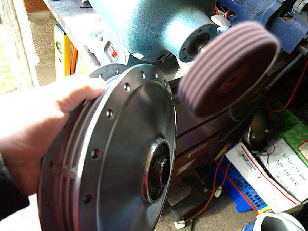

You're welcome. For hubs I usually finish with what we call a 'satin finish' mop on my polisher. It's a kind of abrasive pan scourer in the form of a polishing wheel. It gives a fairly authentic finish and gives a good key for the clear coat.
