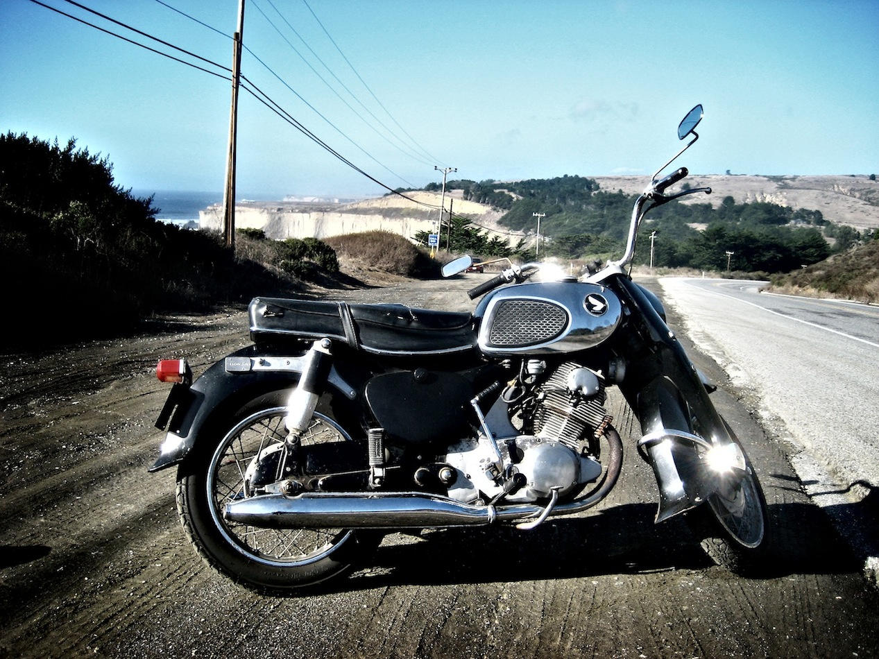

What gas mileage do you guys get? I went on a 100 mile ride and I probably used 3 gallons of gas....seems like a lot for the bike. Is this normal? Oh here's a picture of the bike on HW 1 !!!! It's been photoshopped, it's really not that shiny..
