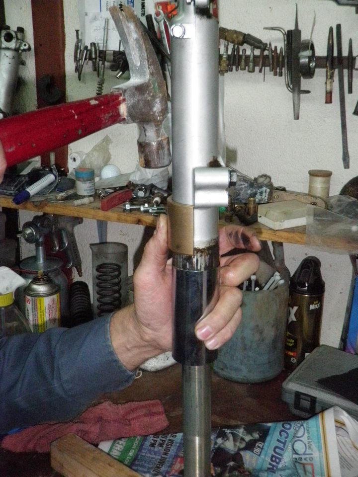

On my 1966 cb77 the chrome covers had to be slid off. However, mine have NEVER been off in the bike's whole life. They were very stuck! PB blaster over various days did not get them loose. Various attempts at making my own strap wrench out of sundry straps was to no avail. My good friend Brian saved me when he brought over a huge bronze bushing that we could cut more or less in half (we left one side larger). The bushing was roughly the size of the fork tube, and with a tiny bit of squeezing in the vice, we fit the bushing to the chrome cover.
A bit of tapping on the cover, and off it came with no damage and no problems. I suppose if you don't have a large, bronze bushing like my friend did, you could find a piece of pipe. It just needs to fit pretty snug on the chrome cover. Once off, you can take out the snap ring, and the seals come right out like described in this forum elsewhere - just pull sharply on the inside tube, and the seal will come out.
Large bushing cut in half to use for hammering off the cover
Gently tapping the cover off using the half-of-a-large-bushing.
