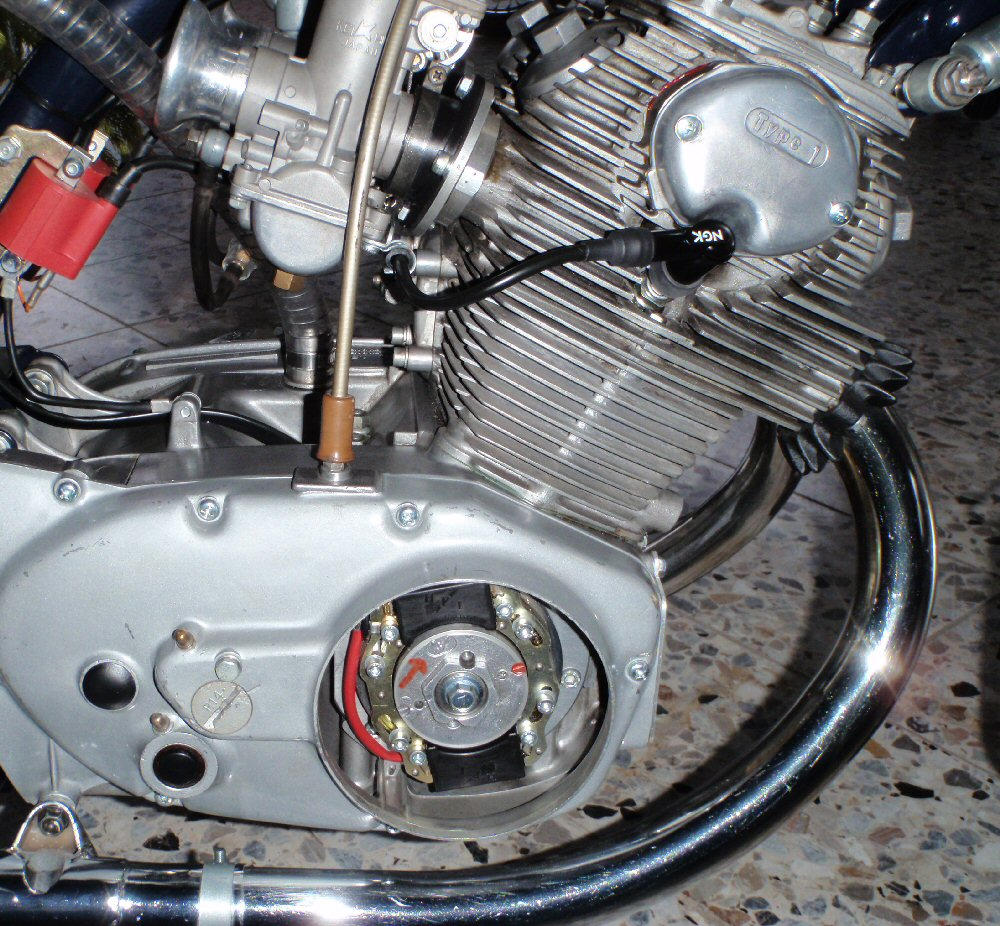

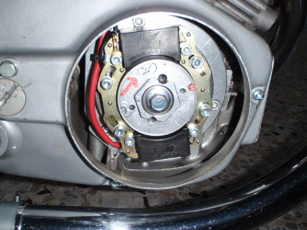

Post by jensen » Fri Dec 10, 2010 6:00 pm
Hi,
Try this : http://www.hpi.be/
Jensen

Post by gltrench » Fri Dec 10, 2010 11:39 pm
Hi Jensen,
Thanks for the tip. Is this your bike? If so, how do you like it? I didn't see any pricing on their site, about how much was it?
Thanks,
-Gabe
